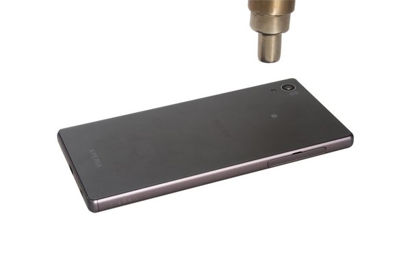

    • Heat the back cover to soften the adhesive sticker.
    • Place the suction cup and inert metal opening tool to open a gap from top side.

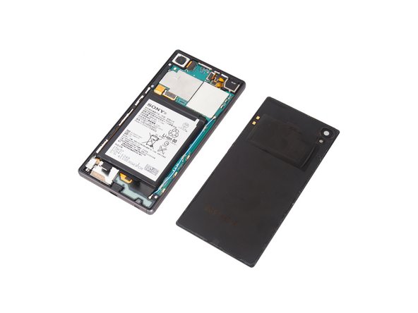

    • Insert the guitar pick and slide it to cut the adhesive sticker underneath.
    • Remove back cover.
