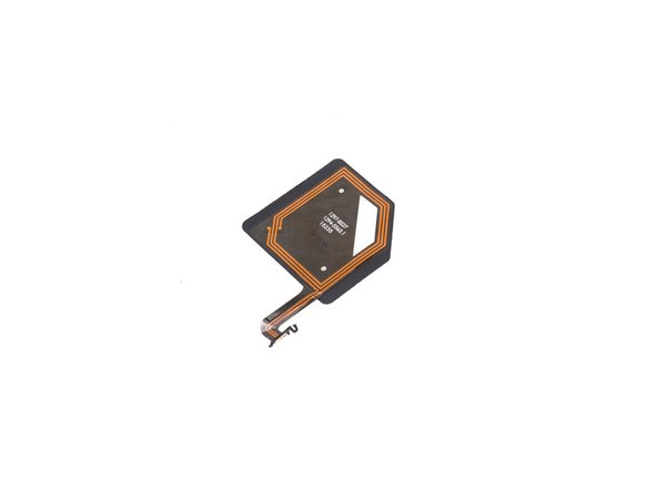

      • Take away NFC antenna on battery.
      • Be aware that the NFC antenna is held by an adhesive and made of thin plastic. Remove it very carefully.

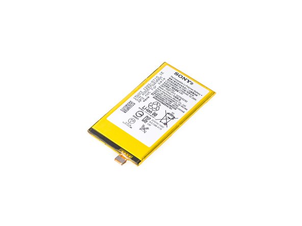

      • Release battery connector.
      • Pull straight out on the black ends of the battery adhesive strips until they come off.
      • Pry up and remove battery.
