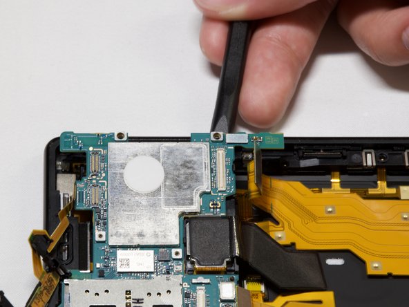

    4. Sony Xperia XZ2 Rear Camera Replacement: step 13, image 1 of 1
      • Gently lift the proximity sensor bracket by using a spudger.

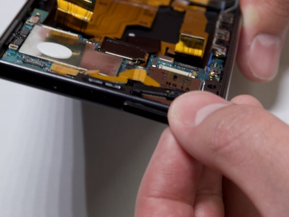

    5. Sony Xperia XZ2 Rear Camera Replacement: step 14, image 1 of 2 Sony Xperia XZ2 Rear Camera Replacement: step 14, image 2 of 2
      • Remove the SIM card holder.

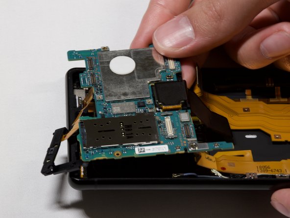

    6. Sony Xperia XZ2 Rear Camera Replacement: step 15, image 1 of 1
      • Pry off the flex connector using the spudger.
      Ask FixBot

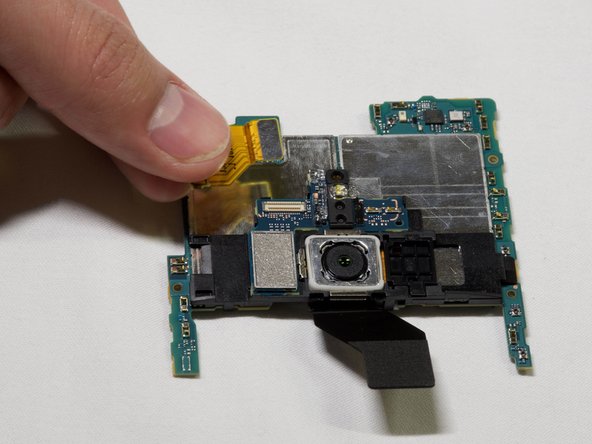

    7. Sony Xperia XZ2 Rear Camera Replacement: step 16, image 1 of 3 Sony Xperia XZ2 Rear Camera Replacement: step 16, image 2 of 3 Sony Xperia XZ2 Rear Camera Replacement: step 16, image 3 of 3
      • Use the spudger to lift the motherboard out of the phone.
      Ask FixBot

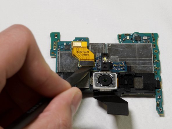

    8. Sony Xperia XZ2 Rear Camera Replacement: step 17, image 1 of 3 Sony Xperia XZ2 Rear Camera Replacement: step 17, image 2 of 3 Sony Xperia XZ2 Rear Camera Replacement: step 17, image 3 of 3
      • Disconnect the yellow connector by gently prying both sides of it using a spudger.

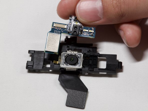

    10. Sony Xperia XZ2 Rear Camera Replacement: step 19, image 1 of 2 Sony Xperia XZ2 Rear Camera Replacement: step 19, image 2 of 2
      • Remove the upper module by gently lifting it with a spudger.

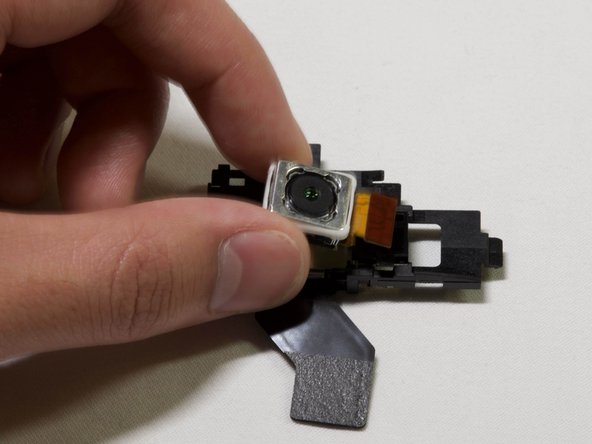

    11. Sony Xperia XZ2 Rear Camera Replacement: step 20, image 1 of 3 Sony Xperia XZ2 Rear Camera Replacement: step 20, image 2 of 3 Sony Xperia XZ2 Rear Camera Replacement: step 20, image 3 of 3
      • Gently lift up the rear camera by using a spudger under the rear camera.
