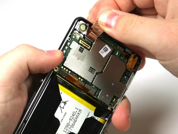

    3. Sony Xperia XA Front Camera Replacement: step 9, image 1 of 2 Sony Xperia XA Front Camera Replacement: step 9, image 2 of 2
      • Use the flat end of the spudger to peel up the copper tab to the right of the back camera.
      • Peel back the tab past the connector.
      • Tab is stuck with adhesive.
