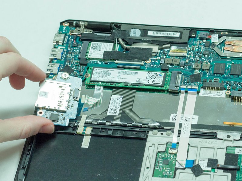

      • Using the flat end of the spudger, pry the edge of the ribbon wire on top of the memory card so it is loose enough to detach from the memory card.
      Ask FixBot
    4. Sony Vaio Pro 13 Memory Card Reader/Writer Replacement: step 7, image 1 of 3 Sony Vaio Pro 13 Memory Card Reader/Writer Replacement: step 7, image 2 of 3 Sony Vaio Pro 13 Memory Card Reader/Writer Replacement: step 7, image 3 of 3
      • Lift up the small, square, black piece of tape that covers the screw on the memory card.
      • Using the philips head 00, unscrew the screw holding the memory card in place.
      • Once the screw is out, the memory card should lift up easily.
      Ask FixBot
