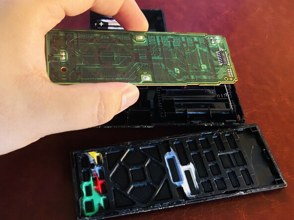

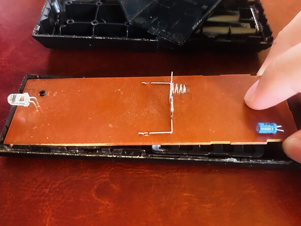

    3. Sony RMT-VB201U Remote Control Button Contact Restoration: step 3, image 1 of 2 Sony RMT-VB201U Remote Control Button Contact Restoration: step 3, image 2 of 2
      • The three internal components are the black rubber keypad, the circuit board with a metallic green side and light brown coating, and the two-piece plastic controller case.
      • Carefully separate each component and place them on your workspace.
      Ask FixBot
    4. Sony RMT-VB201U Remote Control Button Contact Restoration: step 4, image 1 of 2 Sony RMT-VB201U Remote Control Button Contact Restoration: step 4, image 2 of 2
      • Remove the circuit board by its edges using your fingers.
      • Place the board green side down to protect the components on the brown side.
      • Push the rubber keypad away from the button side of the plastic cover to remove it.

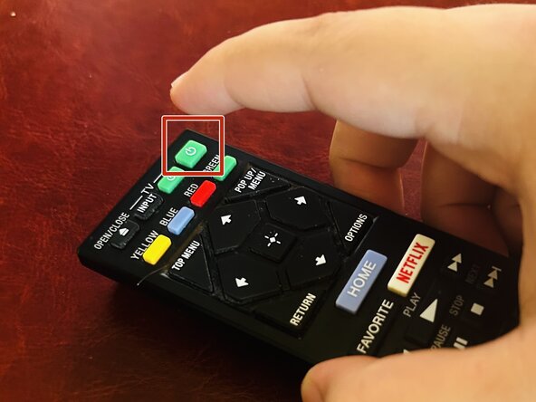

    10. Sony RMT-VB201U Remote Control Button Contact Restoration: step 10, image 1 of 2 Sony RMT-VB201U Remote Control Button Contact Restoration: step 10, image 2 of 2
      • Press the power button to confirm the controller powers on.
      • Aim the controller at the Blu-ray player and confirm the player powers on and the LED light activates.
      Ask FixBot
After completing the repair, test the remote by pressing each button to make sure all of the rubber buttons are working properly.
