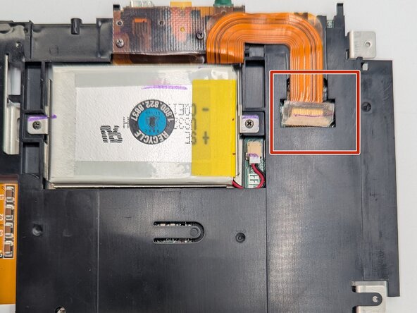

    5. Sony PRS-505 USB Port Replacement: step 6, image 1 of 1
      • Disconnect the ribbon cable.
      • Carefully continue to push the inner body of the device towards the top until the battery is accessible.
