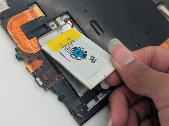

      • Carefully continue to push the inner body of the device towards the top until the battery is accessible.
      Ask FixBot
    6. Sony PRS-505 Screen Replacement: step 7, image 1 of 3 Sony PRS-505 Screen Replacement: step 7, image 2 of 3 Sony PRS-505 Screen Replacement: step 7, image 3 of 3
      • Gently pry the battery from its placeholder within the device’s inner body. Disconnect and remove the battery.
      • If the battery won’t come out, remove the entire compartment by removing the two 3 mm screws with a Phillips #000 screwdriver.
      Ask FixBot
