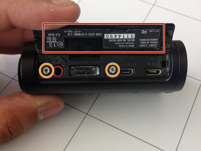

    1. Sony HDR-AS30V Outer Casing Replacement, Outer Casing: step 1, image 1 of 1
      • Power off the device. Remove the component jack cover.
      • Open component door.
      • Using the Phillips 00 screwdriver, remove the two screws holding the jack cover in place.
