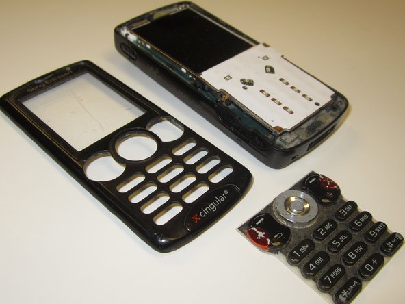

    6. Sony Ericsson W810I Camera Lens Replacement: step 6, image 1 of 3 Sony Ericsson W810I Camera Lens Replacement: step 6, image 2 of 3 Sony Ericsson W810I Camera Lens Replacement: step 6, image 3 of 3
      • Flip the phone over and pry off the front faceplate using multiple blue hand-wedges.
      • Separate the keypad from the logic board by turning it upside down and allowing it to fall into your hand.
      Ask FixBot
