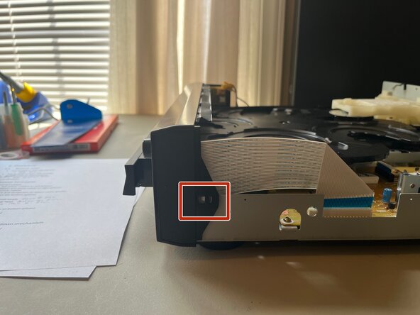

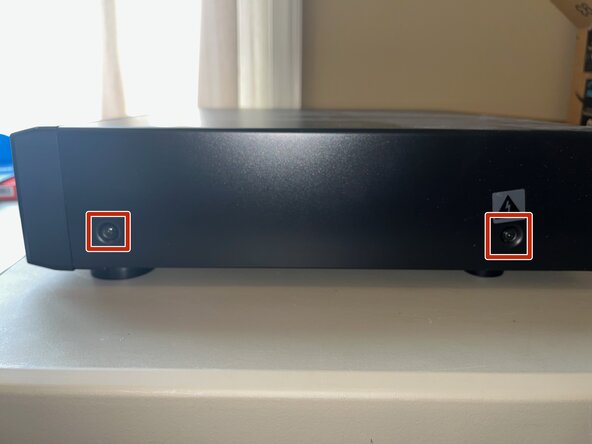

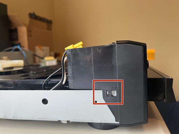

    6. Sony CDP-CE375 Belt Replacement, Remove the screws securing the front panel: step 6, image 1 of 1
      • Remove the four screws that secure the front panel to the frame. Note that there are two screws inside the right-side foot. Both must be removed.
      • Although these screws appear to be almost identical, they are not. Be careful to not mix them up during reassembly.

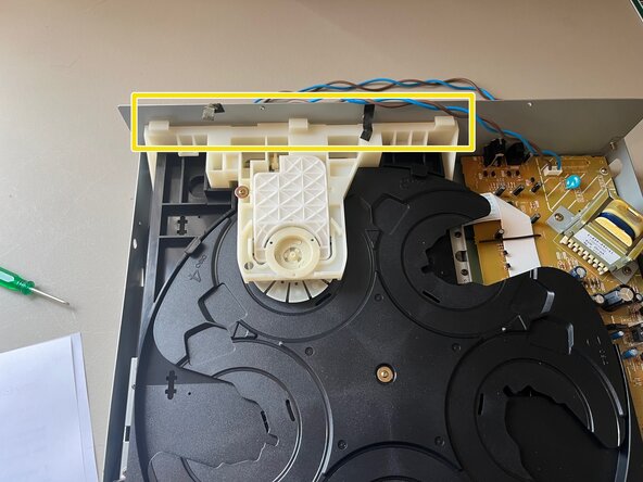

    7. Sony CDP-CE375 Belt Replacement, Partially open the CD tray: step 7, image 1 of 2 Sony CDP-CE375 Belt Replacement, Partially open the CD tray: step 7, image 2 of 2
      • Using a small flat-blade screwdriver, turn the white plastic screw located within the indicated hole.
      • There is no need to turn it a lot. One or two turns should be sufficient to unlock the mechanism. You can then gently pull the tray forward a few inches.
      • This is necessary, because the front panel's opening is only wide enough for the CD tray, but its bezel is wider. The panel can be maneuvered around the tray's bezel if the tray is opened partway.

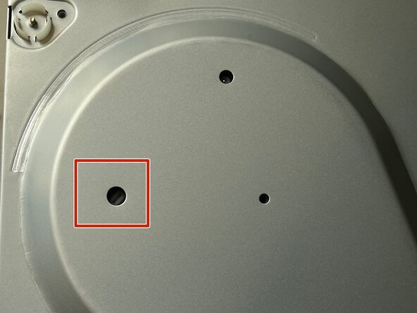

    11. Sony CDP-CE375 Belt Replacement, Remove the first two chassis mounting screws.: step 11, image 1 of 3 Sony CDP-CE375 Belt Replacement, Remove the first two chassis mounting screws.: step 11, image 2 of 3 Sony CDP-CE375 Belt Replacement, Remove the first two chassis mounting screws.: step 11, image 3 of 3
      • Move the tray so it is fully open and rotate it to expose the four chassis mounting screws. Remove them.
      • The red box is the upper-left screw location. See also the close-up photo.
      • The orange box is the upper-right screw location. See also the close-up photo.
      • See the next step for close-up locations of the other two screws.
      • These screws are inset a bit. You will need a screwdriver that is at least 1.5" long, preferably 2" or longer. And you will need a grabber tool to remove them, because the screws are brass (non magnetic).

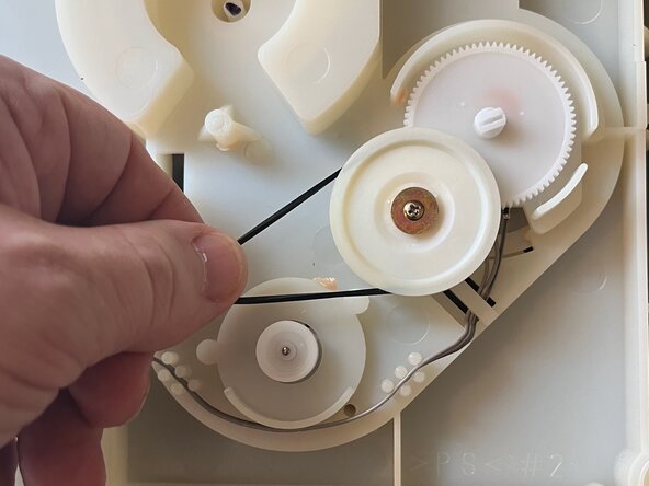

    15. Sony CDP-CE375 Belt Replacement, Replace the loading belt: step 15, image 1 of 3 Sony CDP-CE375 Belt Replacement, Replace the loading belt: step 15, image 2 of 3 Sony CDP-CE375 Belt Replacement, Replace the loading belt: step 15, image 3 of 3
      • Flip the chassis upside down.
      • Remove and discard the old loading belt.
      • If the old belt is broken or missing, look for and remove whatever bits you can find.
      • Inspect the two pulleys. If any dirt or belt residue is present, clean them with isopropyl alcohol and a cotton swab. Allow them to fully dry before attaching the replacement belt.
      • Stretch the new belt across the two pulleys.
