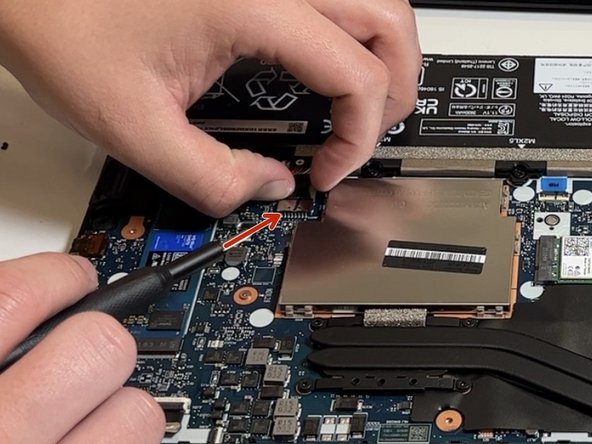

    • Unplug the battery connector and press the power button to ensure the device has no power running.

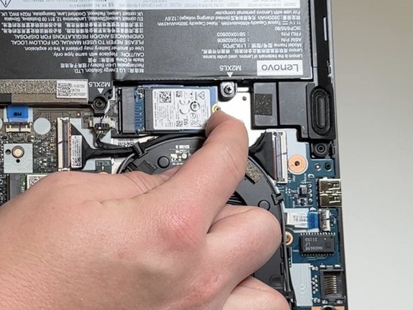

  4. Solid-State Drive Replacement in ThinkPad E14 Gen 2 (AMD): step 4, image 1 of 2 Solid-State Drive Replacement in ThinkPad E14 Gen 2 (AMD): step 4, image 2 of 2
    • Use a Phillips #0 screwdriver to remove the single 4 mm screw that secures the solid-state drive.

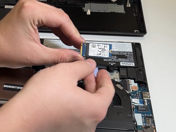

  5. Solid-State Drive Replacement in ThinkPad E14 Gen 2 (AMD): step 5, image 1 of 3 Solid-State Drive Replacement in ThinkPad E14 Gen 2 (AMD): step 5, image 2 of 3 Solid-State Drive Replacement in ThinkPad E14 Gen 2 (AMD): step 5, image 3 of 3
    • Slide the Solid-State Drive out of its slot.
  6. Solid-State Drive Replacement in ThinkPad E14 Gen 2 (AMD): step 6, image 1 of 3 Solid-State Drive Replacement in ThinkPad E14 Gen 2 (AMD): step 6, image 2 of 3 Solid-State Drive Replacement in ThinkPad E14 Gen 2 (AMD): step 6, image 3 of 3
    • Replace the Solid-State Drive with the new one.
