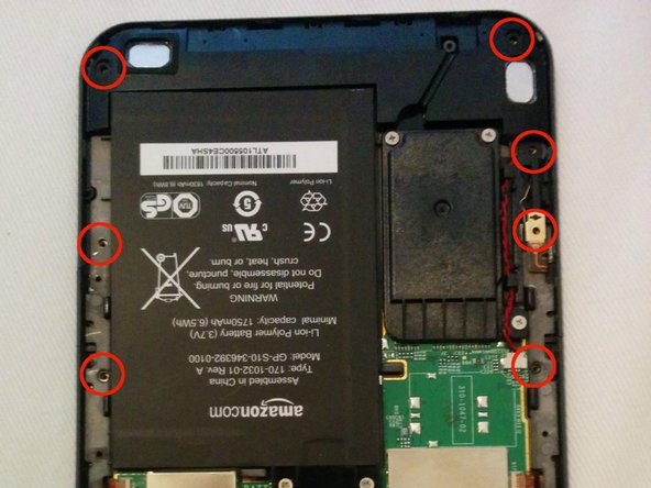

    3. Simplified Kindle 3 Screen Replacement: step 3, image 1 of 2 Simplified Kindle 3 Screen Replacement: step 3, image 2 of 2
      • Necessary 17 screws marked.

      • Remove Screen cable to the left.
      • Remove board, slightly pushing up and left.
      • Push broken screen out of the frame - gently pressing from the outside to the inside. I did not need tools for this, but be careful not to break the frame. Unpack replacement screen, remove protection foil and carefully place it. The glue should still be sufficient.
      • Rearrange keyboard top which has probably fallen off, insert board, some screws and screen cable. Test before closing the case. If not charged beforehand, remember it still might be charging for some time before anything will happen on the screen.
