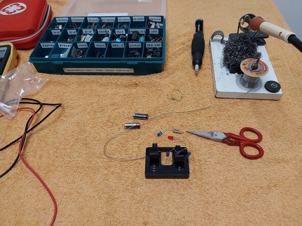

    2. Simple 12V MN21 remote control battery tester.: step 2, image 1 of 2 Simple 12V MN21 remote control battery tester.: step 2, image 2 of 2
      • Assembly process during testing with the diodes separated to make various checks easier; in your case, since we already know it works, you can proceed to step 5.

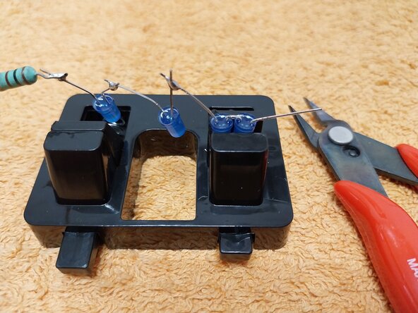

    3. Simple 12V MN21 remote control battery tester.: step 3, image 1 of 3 Simple 12V MN21 remote control battery tester.: step 3, image 2 of 3 Simple 12V MN21 remote control battery tester.: step 3, image 3 of 3
      • Assembly functionality test; first, I perform a test by soldering the LEDs in the air with some separation to see how many LEDs it is most appropriate to use, the design ending up with 4 blue LEDs, just as we see that they light up at 100% with a 12 V dead battery.

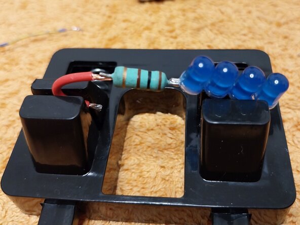

    7. Simple 12V MN21 remote control battery tester.: step 7, image 1 of 2 Simple 12V MN21 remote control battery tester.: step 7, image 2 of 2
      • View of the final assembly and comparison with the diagram.
