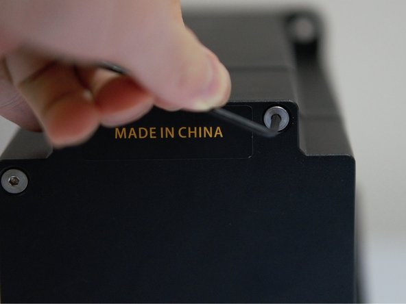

    5. Simagic Alpha Mini Direct Drive Wheelbase Magnet Positional Sensor Replacement: step 5, image 1 of 2 Simagic Alpha Mini Direct Drive Wheelbase Magnet Positional Sensor Replacement: step 5, image 2 of 2
      • Rotate the wheelbase 180 degrees so the bolts on the back of the device are facing you.
      • Use a 2.5mm M3 Hex Key to remove four 4 mm screws.
      Ask FixBot

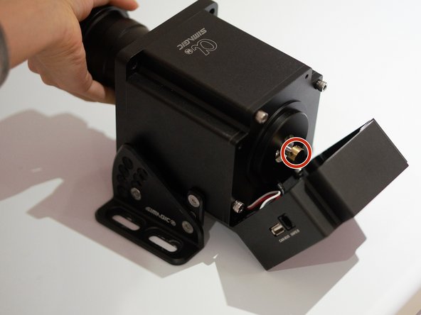

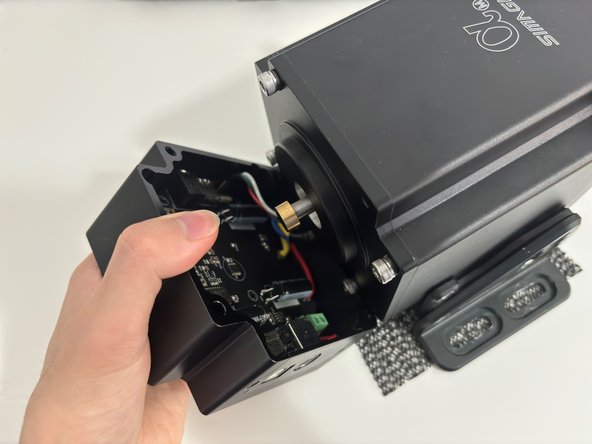

    6. Simagic Alpha Mini Direct Drive Wheelbase Magnet Positional Sensor Replacement: step 6, image 1 of 1
      • Open the electronics cover.
      • As you open the electronics cover, be careful not to unplug or tear the wires connecting the cover to the wheelbase.
      Ask FixBot

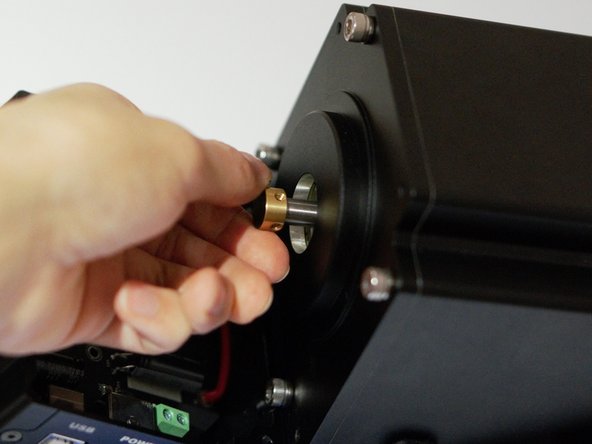

    7. Simagic Alpha Mini Direct Drive Wheelbase Magnet Positional Sensor Replacement: step 7, image 1 of 2 Simagic Alpha Mini Direct Drive Wheelbase Magnet Positional Sensor Replacement: step 7, image 2 of 2
      • Use a 1.5mm M1 Hex Key two remove two 5 mm screws from the back magnet.
      Ask FixBot

    9. Simagic Alpha Mini Direct Drive Wheelbase Magnet Positional Sensor Replacement: step 9, image 1 of 2 Simagic Alpha Mini Direct Drive Wheelbase Magnet Positional Sensor Replacement: step 9, image 2 of 2
      • Ensure the Wi-Fi symbol located on the front of the wheelbase is facing straight up prior to turning the magnet.
      • Turn the magnet clockwise until one of the screw holes is facing up and the other screw hole is facing right to realign the positional sensor (magnet).
      Ask FixBot
    10. Simagic Alpha Mini Direct Drive Wheelbase Magnet Positional Sensor Replacement: step 10, image 1 of 1
      • Use a 1.5 mm M1 Hex Key to tighten two 5 mm screws and secure the sensor into position.
      Ask FixBot
    11. Simagic Alpha Mini Direct Drive Wheelbase Magnet Positional Sensor Replacement: step 11, image 1 of 1
      • To check if you have aligned the sensor correctly, launch the Alpha Manager application. On the screen that follows, ensure the wheel is 0.0.
      Ask FixBot
