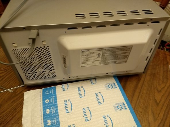

    2. Sharp Microwave Door Switch Replacement, Remove screws: step 2, image 1 of 3 Sharp Microwave Door Switch Replacement, Remove screws: step 2, image 2 of 3 Sharp Microwave Door Switch Replacement, Remove screws: step 2, image 3 of 3
      • Side screw
      • ...and 4 screws in the back
      • Star screws need T15X4 or equivalent. A flathead can be used in a pinch.
      • Remove the screws

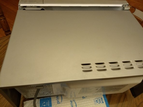

    3. Sharp Microwave Door Switch Replacement, Remove the screws (5 in number)): step 3, image 1 of 3 Sharp Microwave Door Switch Replacement, Remove the screws (5 in number)): step 3, image 2 of 3 Sharp Microwave Door Switch Replacement, Remove the screws (5 in number)): step 3, image 3 of 3
      • Remove the case, should slide out with a little bit of effort.due to notches in the frame on the front top left ( when looking from the back).

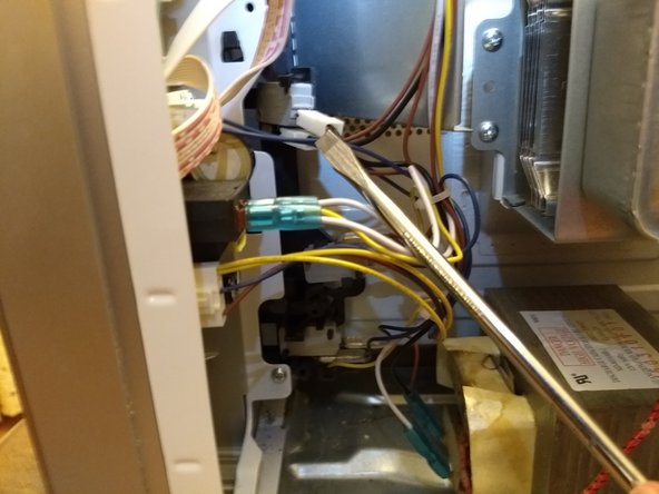

    4. Sharp Microwave Door Switch Replacement, Microwave with the cover open: step 4, image 1 of 3 Sharp Microwave Door Switch Replacement, Microwave with the cover open: step 4, image 2 of 3 Sharp Microwave Door Switch Replacement, Microwave with the cover open: step 4, image 3 of 3
      • Now we will identify the switches
      • The lower two switches
      • ... and the upper switch
      • Upper switch faulty

    5. Sharp Microwave Door Switch Replacement, Replacement of the switch: step 5, image 1 of 3 Sharp Microwave Door Switch Replacement, Replacement of the switch: step 5, image 2 of 3 Sharp Microwave Door Switch Replacement, Replacement of the switch: step 5, image 3 of 3
      • Top switch appears loose
      • Replace and reinstall
      • Angled reinsertion to line up hole with plastic support

Some Sharp Microwaves use different Torx screws. The T15 didn't fit the screws on my model, it appears to be the security version of the T15. I suggest getting a set such as the Mako instead.
DBDigital - Reply Share
Sometimes 2 of 6 cabinet screws are security style. Adjusting small needle nose vise-grip pliers very tightly and pointed directly around round screw head parallel to screw thread can loosen the sheet metal screw.
