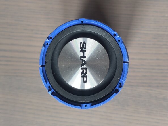

    4. Sharp GX-BT280 replacement battery replacement, Remove the membrane: step 5, image 1 of 3 Sharp GX-BT280 replacement battery replacement, Remove the membrane: step 5, image 2 of 3 Sharp GX-BT280 replacement battery replacement, Remove the membrane: step 5, image 3 of 3
      • Remove the 6 marked screws. When reassembling later, make sure to note that one tab (highlighted in orange in the image) is slightly wider than the others.
      • Remove the black ring. Beneath the ring is a rubber membrane; remove this as well. It may be slightly stuck, but it can be easily released.
      • Afterwards, you have an initial look inside. It may be helpful to use a thick rubber band to hold the two halves of the speaker together.
      • Proceed accordingly on the other side of the speaker.

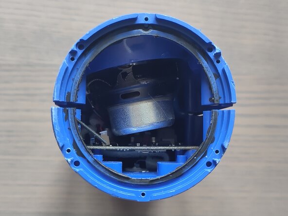

    5. Sharp GX-BT280 replacement battery replacement, Removing the battery bracket: step 6, image 1 of 2 Sharp GX-BT280 replacement battery replacement, Removing the battery bracket: step 6, image 2 of 2
      • The two halves of the speaker can now be carefully opened slightly. Note that both halves are connected by cables, so do not pull them completely apart.
      • The battery is secured with a bracket held by two screws (only one visible in the image). Release both screws and the battery connector (see second image), then the battery can be removed.
