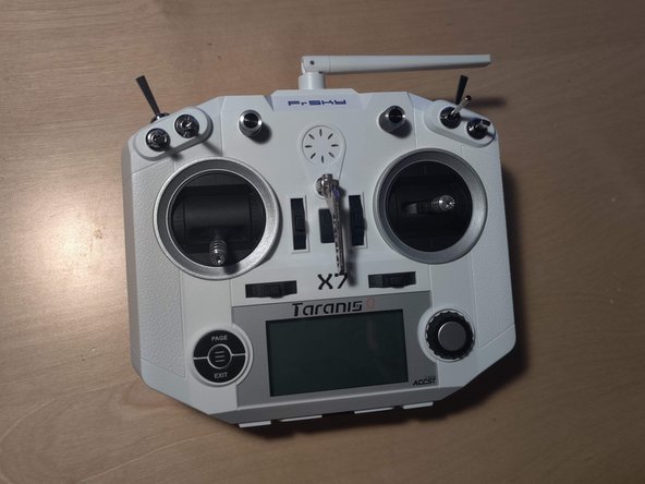

Setting Throttle Mode on the FrSky Taranis QX7
  1. Setting Throttle Mode on the FrSky Taranis QX7, FrSky Taranis QX7 Throttle Mode Setting: step 1, image 1 of 1
    • The FrSky Taranis QX7 comes out of the box with both sticks centered on both axes.
    • In order to fly model aircraft, one stick must move freely in the vertical direction to act as throttle control.
    • This guide will show how to convert the QX7 into Mode 2, where the throttle is on the left stick.
    • If you wish to convert the radio into Mode 1, simply follow this guide with the right stick rather than the left.

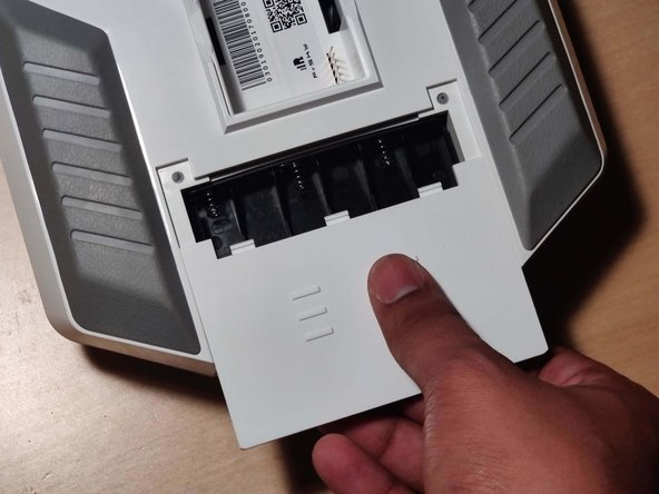

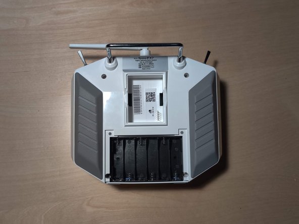

    • To begin disassembly, turn the radio over and remove the expansion bay cover using the squeeze tabs.
    • Remove the battery bay cover by sliding it downwards.

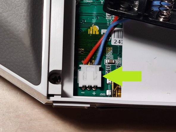

    • Using your thumbs, push out and towards you on the sides of the battery case and remove it from the battery bay.

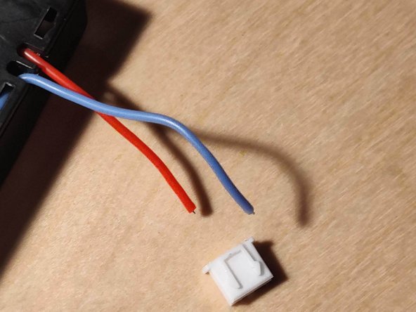

    • Taking care to not strain the cable connecting the batteries to the radio, disconnect the battery connector. Make sure to grab the actual connector and not pull by the cable (like I did). A small pry tool may make this step easier.
    • If the connector wont budge, do NOT try to force the cable out (like I did) as it may be stuck on a small surface mounted diode on the circuit board. Simply pull the connector towards you slightly to get it unstuck. The cable should now disconnect freely by pulling it upwards.

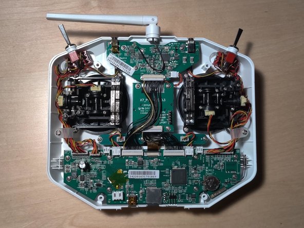

    • Using a #1 Phillips head screwdriver, remove the 4 indicated screws from the back case.

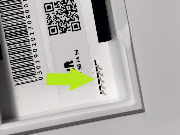

    • As you remove the back case, take care to not damage the 5 pins in the expansion bay, as they slot through the back case.
    • Remove the back case completely from the radio.
  5. Setting Throttle Mode on the FrSky Taranis QX7: step 5, image 1 of 1
    • If converting to Mode 2, the rest of this guide will applied to the transmitters left gimbal (right gimbal in orientation shown).
    • If converting to Mode 1, apply the remainder of this guide to the transmitter's right gimbal (left gimbal in orientation shown).

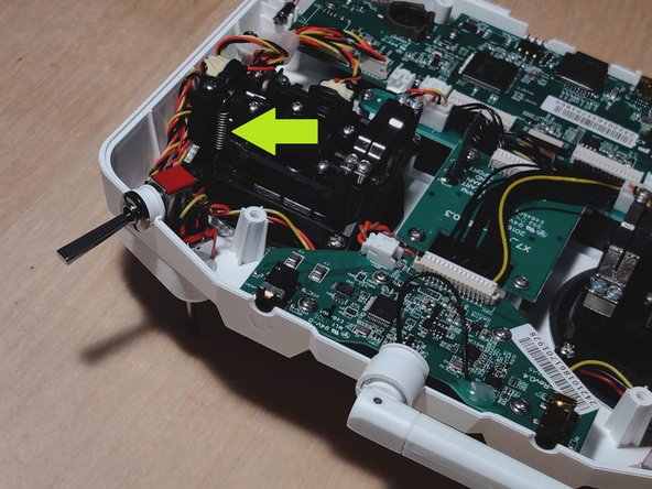

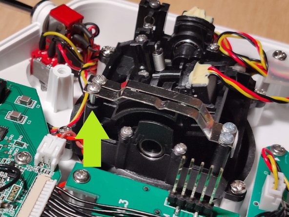

    • To remove spring tension on the vertical axis, find the denoted screw. It should be almost completely unscrewed from its hole and sticking out of the gimbal.
    • With a #1 Phillips head screwdriver, tighten this screw until it is snug. As you screw it down, you should notice the spring on the other side of the gimbal slowly expand into an extended position.
    • The stick should now flop around freely on the vertical axis.

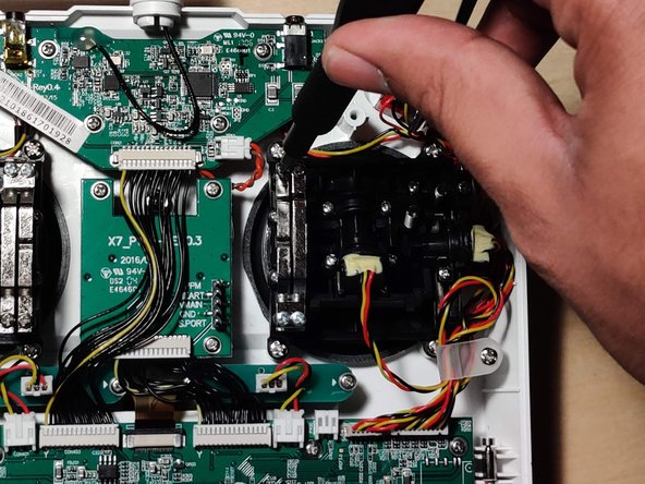

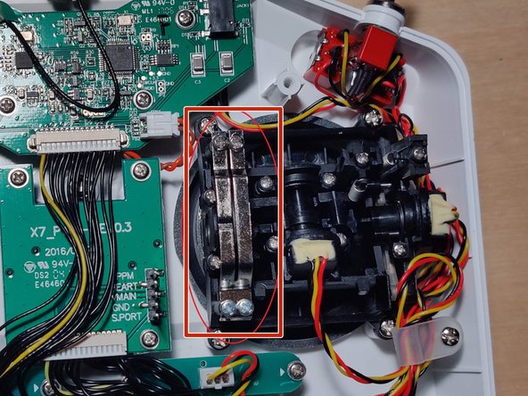

    • In order to add resistance to the vertical axis, find the set of metal bands on the side of the gimbal.
    • Note that one side of the bands is completely screwed in, while the other has room for adjustment. Pick one of the screws on the latter side.
    • For a ratcheting throttle that clicks when adjusted, screw in the band with a notch. For a smooth throttle, screw in the band without the notch.
    • Using a #1 Phillips head screwdriver, tighten the selected screw until the desired amount of resistance is reached.
    • The throttle should now stay in a set position without unwanted movement.

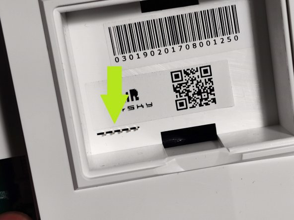

    • Put the back case back onto the radio, taking care to line up the pins in the expansion bay.
    • Secure the back case by reinstalling the 4 case screws using a #1 Phillips head screwdriver.
