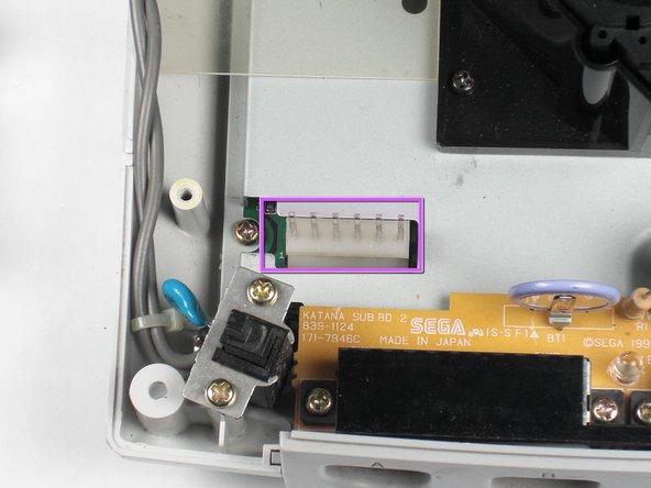

  5. Sega Dreamcast Power Supply Replacement, Power Supply: step 5, image 1 of 2 Sega Dreamcast Power Supply Replacement, Power Supply: step 5, image 2 of 2
    • Unplug the device from the outlet. If you have just powered off the system, allow a few minutes for the capacitors to discharge before you begin working.
    • Remove the white female pin head by pinching and lifting directly up on the harness.
    • Remove the two Philips #02 screws from the board.
    • Remove the power board. Using both hands, gently lift the power board away from the console without damaging the male pin head
