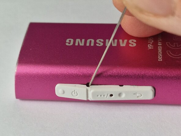

    1. Samsung YP-U6 Battery Replacement, Battery: step 1, image 1 of 3 Samsung YP-U6 Battery Replacement, Battery: step 1, image 2 of 3 Samsung YP-U6 Battery Replacement, Battery: step 1, image 3 of 3
      • Use a sewing needle to pry off the controls on the side of the U6, this will open up a small hole that will be used later.
      • The buttons are made of plastic so I'd recommend not bending them too much when prying off.

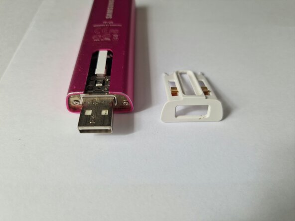

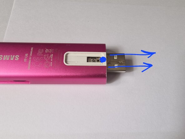

    3. Samsung YP-U6 Battery Replacement: step 3, image 1 of 3 Samsung YP-U6 Battery Replacement: step 3, image 2 of 3 Samsung YP-U6 Battery Replacement: step 3, image 3 of 3
      • The plastic that surrounds the USB connector comes off next, the easiest way I have found is to use a fingernail do pull the plastic part away from the device from the blue spot shown in the image.
      • This part is lightly adhered to the metal underneath it, so it'll come off slightly harder the first time round.

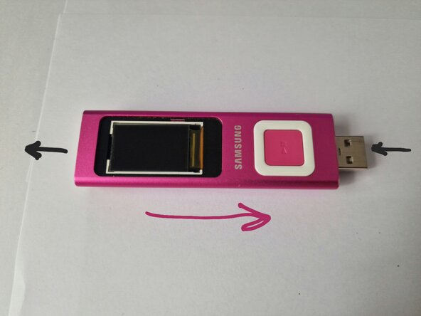

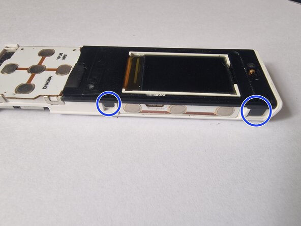

    6. Samsung YP-U6 Battery Replacement: step 6, image 1 of 3 Samsung YP-U6 Battery Replacement: step 6, image 2 of 3 Samsung YP-U6 Battery Replacement: step 6, image 3 of 3
      • With the screen off, the entire assembly should push out from the top (I pushed from the USB connector as it is a metal assembly and should be strong enough).
      • There may still be some resistance from any leftover adhesive or an expanded battery, overall it should still slide relatively easily.
      • The button assembly will fall out of place, when reassembling it's useful to put them in place first and slide the assembly back in with the device button-side down so they stay in place (remember to check they're the right orientation beforehand).

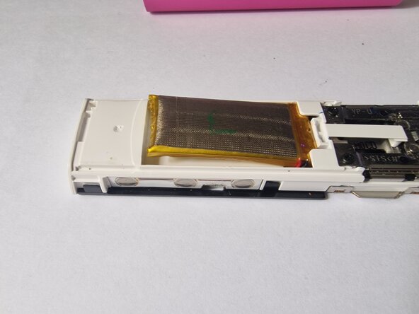

    7. Samsung YP-U6 Battery Replacement: step 7, image 1 of 3 Samsung YP-U6 Battery Replacement: step 7, image 2 of 3 Samsung YP-U6 Battery Replacement: step 7, image 3 of 3
      • The battery is located on the back on the assembly and relatively easy access.
      • HOWEVER, these players are quite old and not as popular as the iPods, therefore 1:1 replacement parts are near impossible to find, so using a standard-part battery of same voltage and size is a valid strategy to revive these types of players.
