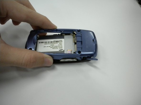

  9. Samsung SCH-U340 Logic Board Assembly Replacement, Lower Casing: step 9, image 1 of 1
    • The lower casing is held on by four screws in the corner of the battery enclosure. Remove these screws.
  10. Samsung SCH-U340 Logic Board Assembly Replacement: step 10, image 1 of 2 Samsung SCH-U340 Logic Board Assembly Replacement: step 10, image 2 of 2
    • Use a spudger to pry the back assembly off of the device.
