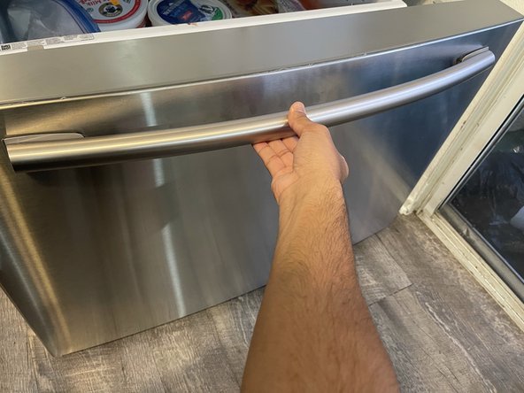

Samsung RF263BEAESR Freezer Door Handle Replacement
  1. Samsung RF263BEAESR Freezer Door Handle Replacement, Freezer Door Handle: step 1, image 1 of 3 Samsung RF263BEAESR Freezer Door Handle Replacement, Freezer Door Handle: step 1, image 2 of 3 Samsung RF263BEAESR Freezer Door Handle Replacement, Freezer Door Handle: step 1, image 3 of 3
    • Use the screwdriver to screw in the door handle opening.

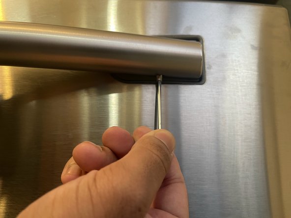

  2. Samsung RF263BEAESR Freezer Door Handle Replacement: step 2, image 1 of 3 Samsung RF263BEAESR Freezer Door Handle Replacement: step 2, image 2 of 3 Samsung RF263BEAESR Freezer Door Handle Replacement: step 2, image 3 of 3
    • Add the screw on the other side of the handle.

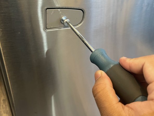

  3. Samsung RF263BEAESR Freezer Door Handle Replacement: step 3, image 1 of 3 Samsung RF263BEAESR Freezer Door Handle Replacement: step 3, image 2 of 3 Samsung RF263BEAESR Freezer Door Handle Replacement: step 3, image 3 of 3
    • Use the screw driver to screw in the mounting screw on both sides of the freezer.

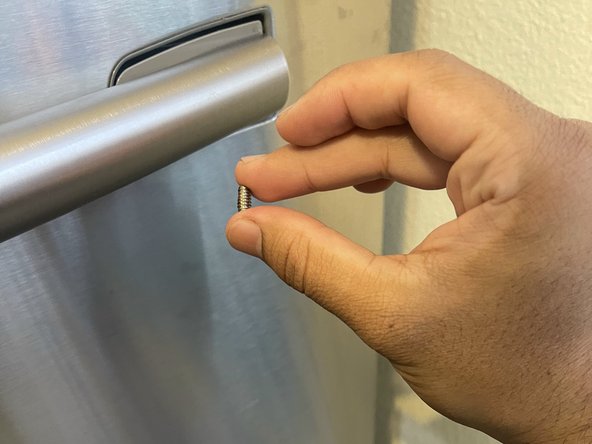

  4. Samsung RF263BEAESR Freezer Door Handle Replacement: step 4, image 1 of 3 Samsung RF263BEAESR Freezer Door Handle Replacement: step 4, image 2 of 3 Samsung RF263BEAESR Freezer Door Handle Replacement: step 4, image 3 of 3
    • Use the Allen key to screw in the small bolt on the bottom right side of the handle.

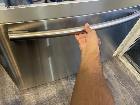

  5. Samsung RF263BEAESR Freezer Door Handle Replacement: step 5, image 1 of 3 Samsung RF263BEAESR Freezer Door Handle Replacement: step 5, image 2 of 3 Samsung RF263BEAESR Freezer Door Handle Replacement: step 5, image 3 of 3
    • If all done correctly, you will have a functioning door handle.

The plastic piece that you screw the mounting screw into is broken on our refrigerator. How can I open up the door to replace that plastic piece? Thanks.
Kevin Bosch - Reply
Hi Kevin, were you able to fix the plastic piece. I also have a similar issue where the plastic broke off
Aneesh Nair -
Any leads on where to buy the plastic part?
Mariola - Reply
4mm is too big, I had to use a 2.5 instead.
Smed - Reply
According to Samsung, that 'plastic piece', also known as the Freezer Door Handle Mounting Cap, (the part that the handle mounting stud is attached through), has no part number... "There are not part numbers assigned to these parts as this model doesn’t allow the replacement of them". The only part option Samsung offers is the Freezer Door Assembly, currently about $350 plus Sales Tax and Shipping.
Once your Samsung appliance gets to be more than 2 or 3 years old, Samsung simply has horrible customer support and unreliable parts support for it's products.
Paul Flam - Reply
