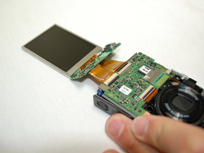

    4. Samsung L100 LCD Screen Replacement: step 9, image 1 of 2 Samsung L100 LCD Screen Replacement: step 9, image 2 of 2
      • Remove the green tape that holds the LCD screen.
      • Carefully lift the LCD Screen.
      Ask FixBot
    5. Samsung L100 LCD Screen Replacement: step 10, image 1 of 3 Samsung L100 LCD Screen Replacement: step 10, image 2 of 3 Samsung L100 LCD Screen Replacement: step 10, image 3 of 3
      • Flip the camera over to the other side.
      • Lift the black strip and the ribbon should easily come out.
      • The LCD Screen should be completely separated from the camera now.
      Ask FixBot
    6. Samsung L100 LCD Screen Replacement: step 11, image 1 of 2 Samsung L100 LCD Screen Replacement: step 11, image 2 of 2
      • Insert the new LCD Screen by pushing the ribbon into the slot.
      • Flip the black strip back down to lock the ribbon in.
      • Your new LCD Screen should be connected to the camera now.
