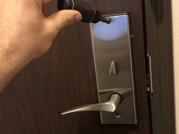

    • Use a T15 Security Torx Screwdriver to remove two screws located at the top and bottom of the face-plate.
    • Remove the face-plate by slipping it back and away from the SAFLOK mechanism.

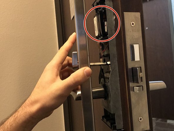

    • Be aware that removing the face-plate may cause the old battery to fall from its cradle, damaging the pins of the circuit board. The battery can be located at the top half of the internal mechanism. It is recommended to use a free hand to hold the battery in place during the removal of the face-plate.

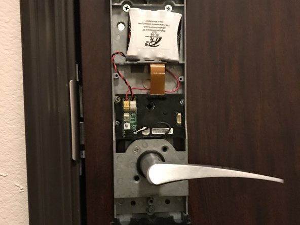

    • This is the inside of the SAFLOK QUANTUM IV
    • This is the battery pack resting upon its cradle within the internal mechanism. This battery is the one that will be replaced within this guide.
    • This plug connects the external RFID reader to the locking mechanism. Make sure not to pull this plug or dislodge it during the removal of the battery or the locking mechanism will not function.
    • Remove the old battery by gently pulling the white batter connector in an upward motion up and away from the pins of the circuit board.
    • Make sure to hold the battery in place while removing the plug.
    • The connector pins are delicate. Do not directly touch the pins with hands or tools.
    • Place a new SAFLOK approved Alkaline, 6V DC, 2,900 mAh battery pack into the cradle located at the top of the internal mechanism. Then slip the connector down onto the pins of the circuit board.
