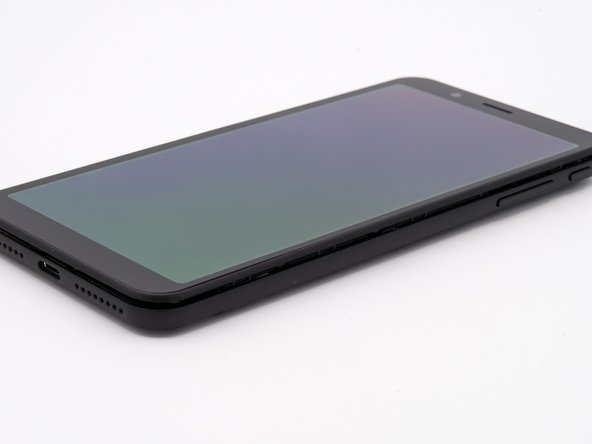

Before you start this guide: Make sure that your display is really defective! Visible cracks could also be on the bulletproof glass and not on the display. If you only have a black screen, it could also be caused by other things, such as the motherboard or the battery.
You can buy a replacement display for your SHIFTPHONE in the official shop from SHIFTPHONES.
The tools you need are a Torx T3 screwdriver and your fingernail. Optionally, you can use a pick, spatula, and tweezers.
You will find the required Torx T3 screwdriver in the original box of your SHIFTPHONE. Otherwise you can of course also buy it.
A good companion for this repair is the professional screwdriver, which is supplied in a robust metal case together with a practical spatula.
Repairing or opening your SHIFTPHONE does not void the warranty. However, you must pay for any costs incurred during or as a result of the repair yourself.
Important: If any step is unusually difficult or something does not want to be solved, please contact us with SHIFT Contact before major damage occurs. There you will receive direct support.
