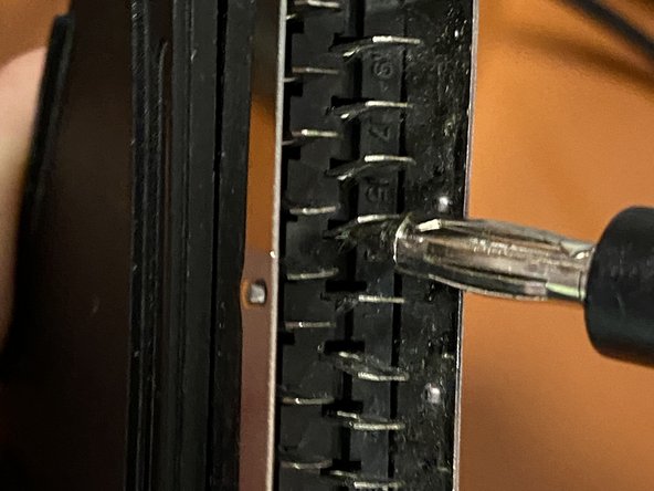

      • Take a multimeter and a SCART cable.
      Ask FixBot
    2. SCART cable continuity test: step 2, image 1 of 2 SCART cable continuity test: step 2, image 2 of 2
      • Set the multimeter to continuity
      Ask FixBot
    3. SCART cable continuity test: step 3, image 1 of 1
      • Place the multimeter probe on the end of the RCA cable.
      Ask FixBot
    4. SCART cable continuity test: step 4, image 1 of 1
      • Place the multimeter probe on the connector pins corresponding to the relevant cables.
      Ask FixBot
    5. SCART cable continuity test: step 5, image 1 of 1
      • If the multimeter beeps, the connection is good.
