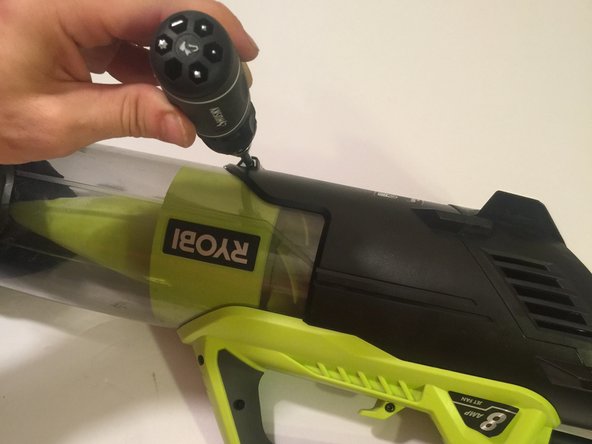

    • Lay the blower on its side so that most of the screw heads are facing up. Identify all 9 screw locations.
    • One screw is located under the sticker with the number 8 on it.
    • Another screw is located on the opposite side.
  2. Ryobi RY42102 Leaf Blower Fan Replacement: step 2, image 1 of 1
    • Using a T15 torx drive(star-head), carefully remove each of the 9 screws and set aside in a secure location. All 9 screws are 10 mm long.

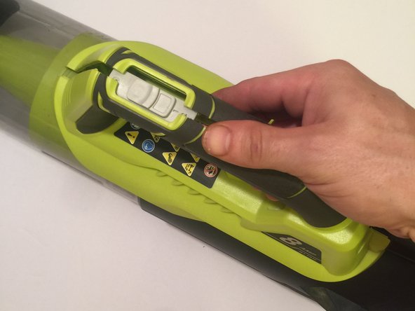

  3. Ryobi RY42102 Leaf Blower Fan Replacement: step 3, image 1 of 2 Ryobi RY42102 Leaf Blower Fan Replacement: step 3, image 2 of 2
    • After all 9 screws have been removed, seperate the handle housing the on/off switch.

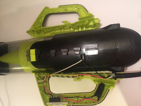

  4. Ryobi RY42102 Leaf Blower Fan Replacement: step 4, image 1 of 1
    • Once the handle has been separated, the blower shaft with detach from the motor housing. Slide the blower shaft out of the motor housing and set aside.

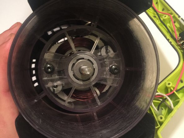

    • Once the blower shaft is detached, the fan will be visible. Use a ratchet with a 1/2" socket to remove the 1/2" nut securing the fan to the motor. This nut is reverse thread so turning it clockwise will loosen it. The fan will also need to be secured so that it does not spin as the nut is being loosened.
