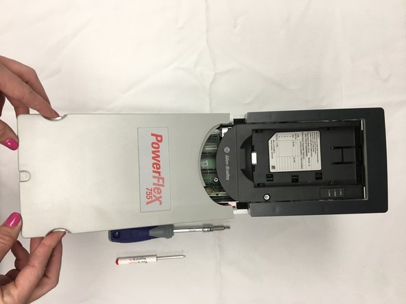

    2. Rockwell Automation PowerFlex 755 Disassembly, Removing the Keypad: step 2, image 1 of 1
      • The PF755 will either have a cover plate, as shown in this guide, or a keypad. To remove these, press on the tab at the top of the drive, and then push the plate or keypad straight up.

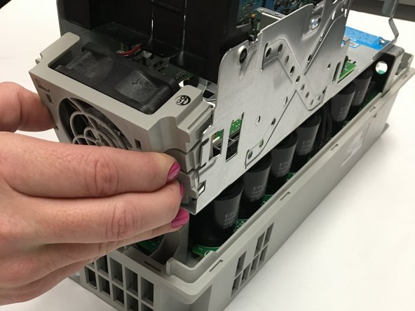

    7. Rockwell Automation PowerFlex 755 Disassembly, Removing the Upper Fan: step 7, image 1 of 1
      • Remove the upper fan by pinching the tabs found on each side and pulling.

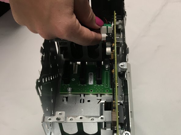

    10. Rockwell Automation PowerFlex 755 Disassembly, Unplugging from the Power Interface Board: step 10, image 1 of 2 Rockwell Automation PowerFlex 755 Disassembly, Unplugging from the Power Interface Board: step 10, image 2 of 2
      • Remove the lower fan connector found at the top of the drive by pulling with two fingers. Be sure to pull on the plastic connector and not on the wires.
      • Remove the four labeled power cables by gripping the plastic on the connectors and pulling. These may be tight. Be patient and apply strong, constant force to remove the connectors. Again, be sure to pull on the connectors and not on the wires.
      Ask FixBot

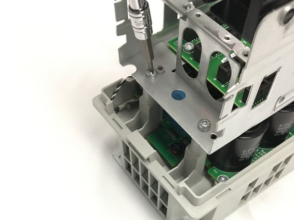

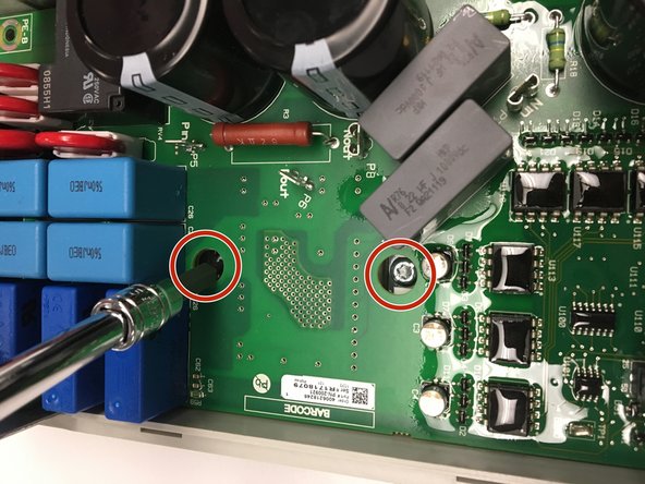

    11. Rockwell Automation PowerFlex 755 Disassembly, Disconnecting the Power Interface Board: step 11, image 1 of 3 Rockwell Automation PowerFlex 755 Disassembly, Disconnecting the Power Interface Board: step 11, image 2 of 3 Rockwell Automation PowerFlex 755 Disassembly, Disconnecting the Power Interface Board: step 11, image 3 of 3
      • Disconnect the power interface board from the lower chassis by removing the four screws on the board as shown. Set these screws aside in a safe place.
      • Remove the three screws shown and place them with the other screws. Be sure not to lose the washers on them.
      • Loosen the two screws found in the holes in the board. These screws only need to be loosened, but be sure not to lose them in the following steps.

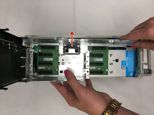

    13. Rockwell Automation PowerFlex 755 Disassembly, Removing the Back Panel: step 13, image 1 of 2 Rockwell Automation PowerFlex 755 Disassembly, Removing the Back Panel: step 13, image 2 of 2
      • Remove the five screws holding the back panel to the lower chassis. Set these aside in a safe place.
      • Lift the plate from the bottom of the drive and slide it off at an angle as shown.

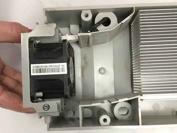

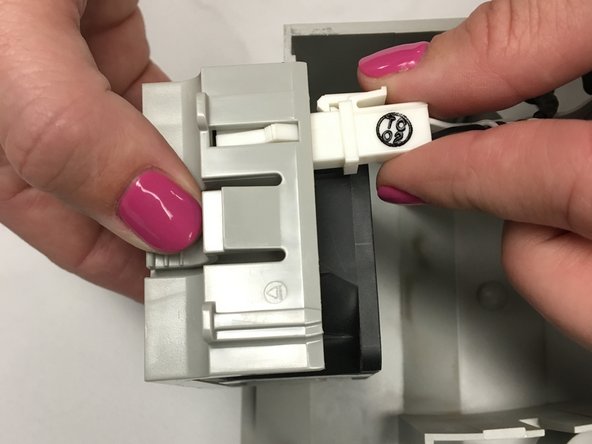

    14. Rockwell Automation PowerFlex 755 Disassembly, Removing the Back Fan: step 14, image 1 of 2 Rockwell Automation PowerFlex 755 Disassembly, Removing the Back Fan: step 14, image 2 of 2
      • Remove the back fan by pinching the tab on both sides and pulling.
      • Disconnect the fan by pinching the latch on the connector and pulling straight out. Be sure to pull on the plastic connector, and not on the wire.
      • The PowerFlex 755 variable frequency drive is now fully disassembled.
