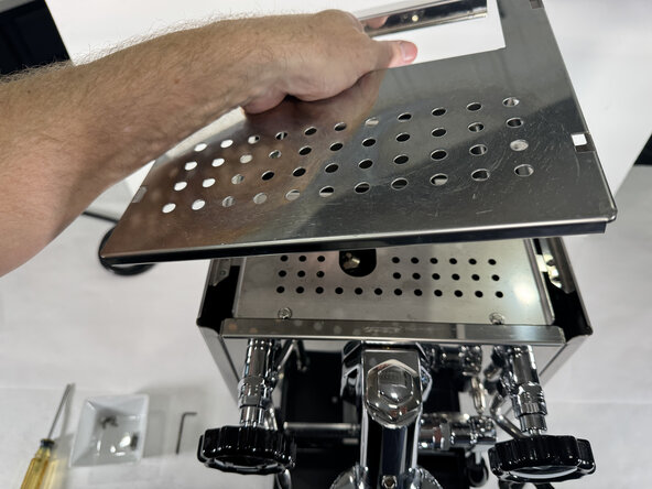

      • Remove the four M3.5 × 6 mm screws from the water reservoir using a #2 Phillips head screwdriver.
      • Use the 2.5 mm Allen key wrench to remove the two M3 × 10 mm screws from the top panel.
      • Lift off the top panel.

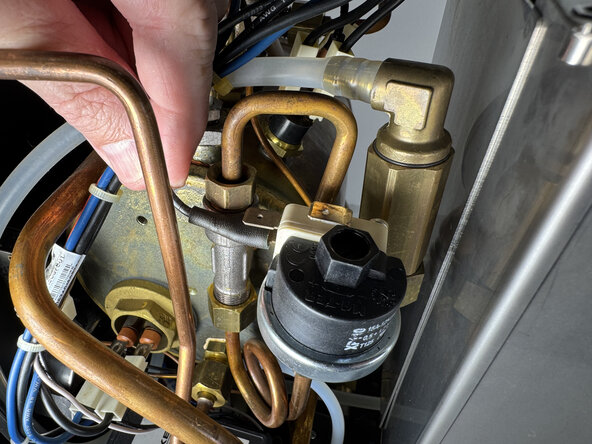

      • Remove the pressurestat: disconnect the blue wire by sliding it off of the top tab.
      • Disconnect the black wire by sliding it off the bottom tab.
      • Using the 17mm wrench to hold the pressurestat in place, use an adjustable wrench to loosen the nut underneath to unscrew completely (Lefty Loosey!). Lift the pressurestat off.

      • Attach the new pressurestat and reconnect it to the nut (Righty-Tighty!). Hand tighten the nut, and then use the adjustable wrench to fully tighten.
      • Reconnect the black wire by sliding it onto the bottom tab on the pressurestat.
      • Reconnect the blue wire by sliding it onto the top tab on the pressurestat.
