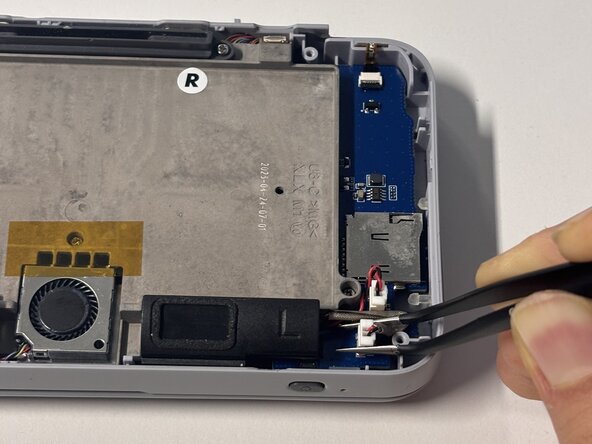

    1. Retroid Pocket Flip Joystick Replacement, Speakers: step 3, image 1 of 1
      • Use tweezers or a spudger to disconnect the two speaker cables at the bottom of the board and remove them.
