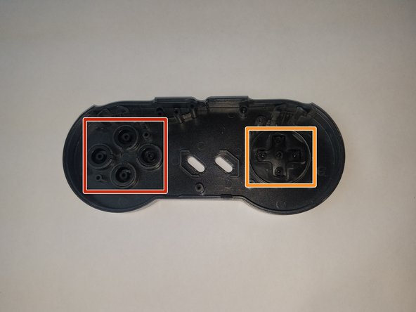

  4. Retro-Bit Retro Duo Controller Button and Pad Replacement.: step 4, image 1 of 3 Retro-Bit Retro Duo Controller Button and Pad Replacement.: step 4, image 2 of 3 Retro-Bit Retro Duo Controller Button and Pad Replacement.: step 4, image 3 of 3
    • To replace the action button pad, lift this part out.
    • Lift the Select and Start button pad.
    • If replacing the D-Pad, lift this pad.
    • Pinch and lift the shoulder button pads.
  5. Retro-Bit Retro Duo Controller Button and Pad Replacement.: step 5, image 1 of 3 Retro-Bit Retro Duo Controller Button and Pad Replacement.: step 5, image 2 of 3 Retro-Bit Retro Duo Controller Button and Pad Replacement.: step 5, image 3 of 3
    • Support the controller face and push buttons toward the inner case.
    • Use care. The buttons have a tiny tab to keep them in place.
    • Support the controller face and push the D-Pad toward the inner case.
