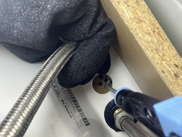

    3. Restroom Sink Replacement: step 3, image 1 of 3 Restroom Sink Replacement: step 3, image 2 of 3 Restroom Sink Replacement: step 3, image 3 of 3
      • Gently loosen the elbow that connects the sink to the pipe leading to the wall with pliers.
      • Use a container to catch any water in the elbow.
      • Don't use too much strength to avoid damage to the wall pipping as you loosen the elbow.

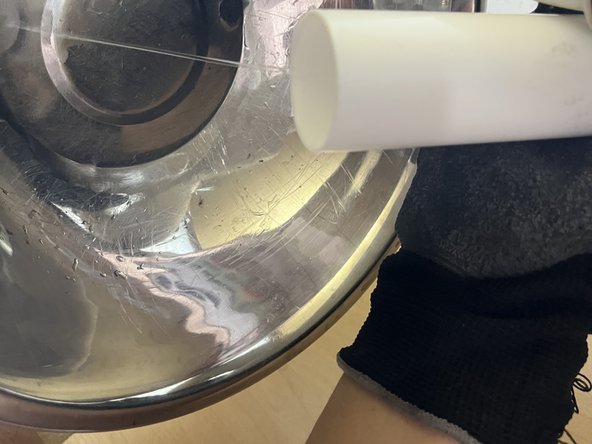

    4. Restroom Sink Replacement: step 4, image 1 of 3 Restroom Sink Replacement: step 4, image 2 of 3 Restroom Sink Replacement: step 4, image 3 of 3
      • With a sharp blade, cut along the old silicon to detach the sink from the cabinet.
      • Use blase with caution to avoid injury to self or damage to the sink.
      • Then detach the hoses from below the sink.
      • Beware, water might be in the hoses as you detach them.

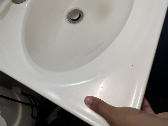

    5. Restroom Sink Replacement: step 5, image 1 of 3 Restroom Sink Replacement: step 5, image 2 of 3 Restroom Sink Replacement: step 5, image 3 of 3
      • When you are done with steps 1 through 4, remove the old sink and replace it with the new one.
      • If your new sink is a newer model, make sure it has the same length and width with a measuring tape.
      • Beware to avoid damage to the sink or cabinet, if it is placed by force.

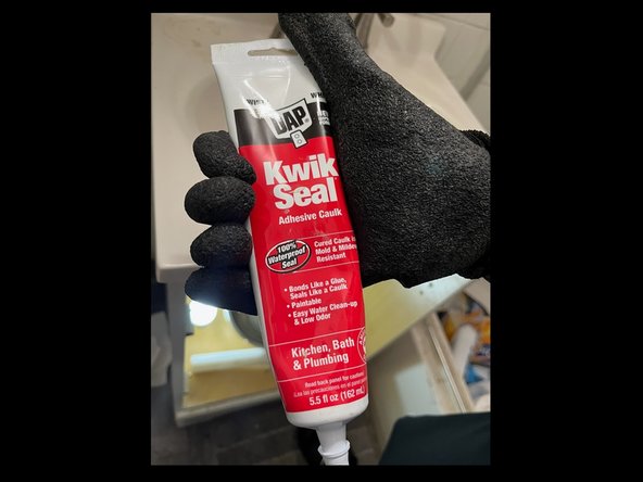

    6. Restroom Sink Replacement: step 6, image 1 of 3 Restroom Sink Replacement: step 6, image 2 of 3 Restroom Sink Replacement: step 6, image 3 of 3
      • Reconnect the hoses and turn on the water with the knobs under the sink, to make sure it runs smoothly.
      • Apply silicon to seal areas around sink and let it dry.
      • Wait for the silicon to dry before using it.
