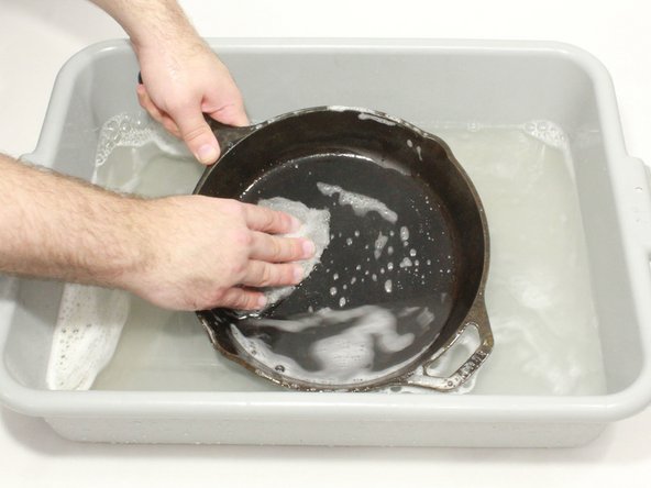

    4. Restoring Cast Iron Cookware: step 4, image 1 of 3 Restoring Cast Iron Cookware: step 4, image 2 of 3 Restoring Cast Iron Cookware: step 4, image 3 of 3
      • Thoroughly rinse and refill the tub with water. A kitchen sink can be used for this step instead.
      • Thoroughly rinse the pan or skillet, then scrub it with steel wool and dish soap.
      • Continue to scrub until there is no remaining rust.

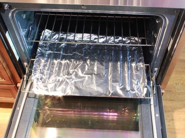

    7. Restoring Cast Iron Cookware: step 7, image 1 of 2 Restoring Cast Iron Cookware: step 7, image 2 of 2
      • Spread aluminum foil on the bottom rack of the oven you intend to use.
      • This is to catch any drips from the oil coated pan.

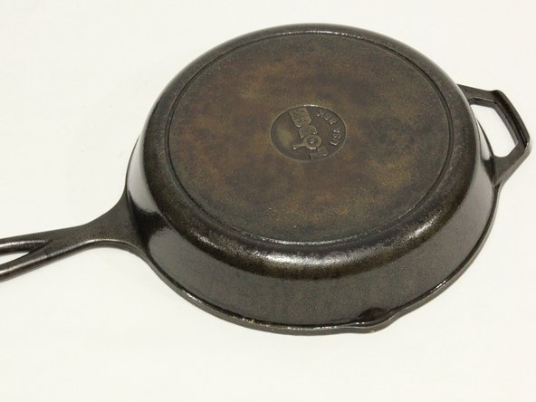

    10. Restoring Cast Iron Cookware: step 10, image 1 of 3 Restoring Cast Iron Cookware: step 10, image 2 of 3 Restoring Cast Iron Cookware: step 10, image 3 of 3
      • Remove the pan from the oven. Then apply a final, and extremely light, coating of vegetable oil to help smooth over any irregularities.
      • If the pan is still hot, use oven mitts to remove it. Burns hurt.
      Ask FixBot
The skillet is now completely restored, good as new. For the best results, reapply the last thin coat of vegetable oil after the next few uses of the cast iron pan or skillet.
