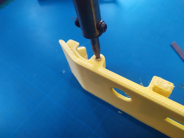

    2. Restart housing installation, Installing the inserts: step 2, image 1 of 3 Restart housing installation, Installing the inserts: step 2, image 2 of 3 Restart housing installation, Installing the inserts: step 2, image 3 of 3
      • Install the threaded inserts (see following steps for sizes).
      • Use a small flat file or any other flat tool to finish pressing the inserts in.
      • If there is plastic on the iron, please clean it with the sponge.
