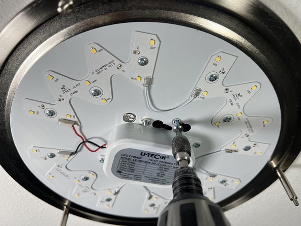

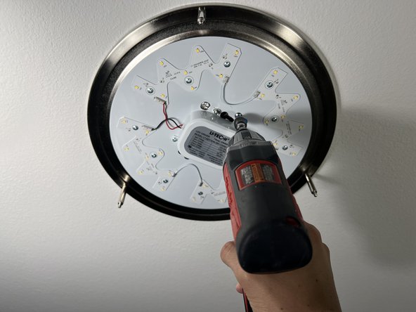

      • Set up a ladder under the light fixture, and remove the three thumb screws holding up the fixture's cover.
      • Hold the light cover with your free hand while you unscrew the last two screws.

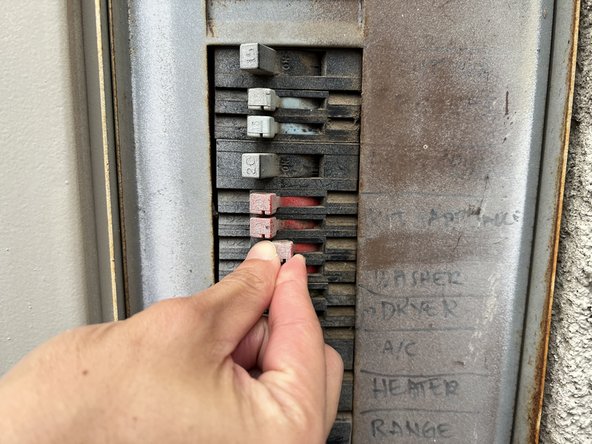

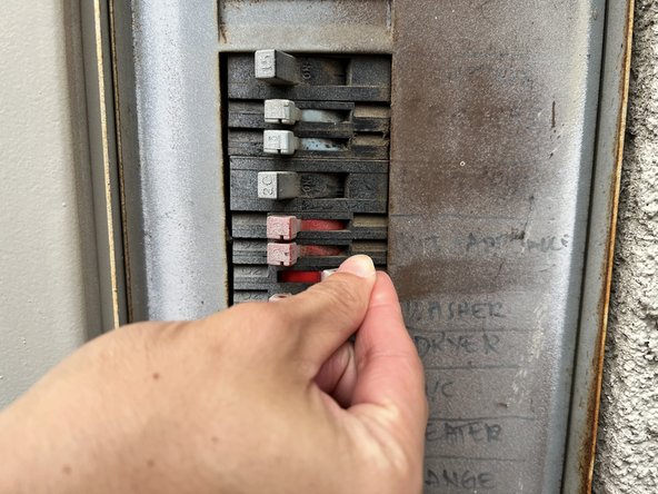

      • Locate the breaker to your house/unit and identify the switch which provides power to the light fixture.
      • Flip the switch on the breaker to the right to turn off the power to the light fixture.
      • Go back to the light fixture, and check if it is still receiving power with the voltage detector.
      • The voltage detector should remain green when placed near the electrical line connected to the light fixture.

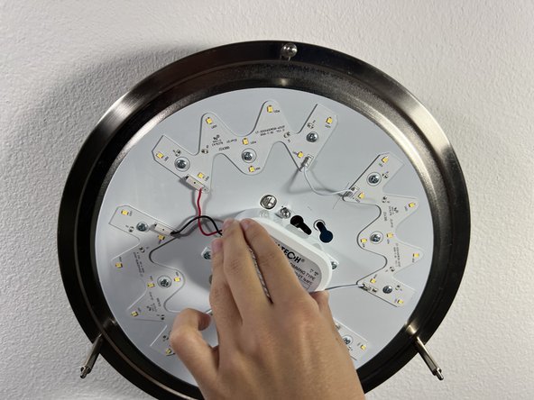

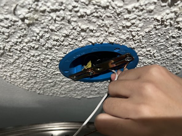

      • Begin unscrewing the base of the light fixture from the ceiling.
      Ask FixBot
    5. Replacing an LED Light Fixture: step 5, image 1 of 3 Replacing an LED Light Fixture: step 5, image 2 of 3 Replacing an LED Light Fixture: step 5, image 3 of 3

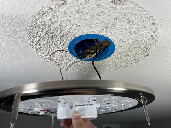

      • Once enough screws are removed from the base of the light fixture, hold the center of the base with your free hand so it doesn't fall down on its own.
      Ask FixBot
    6. Replacing an LED Light Fixture: step 6, image 1 of 2 Replacing an LED Light Fixture: step 6, image 2 of 2
      • While still holding the base of the light fixture, check if the exposed wires are still unpowered with the voltage detector.
      • The voltage detector should remain green when placed near these exposed wires.

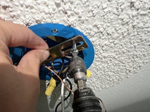

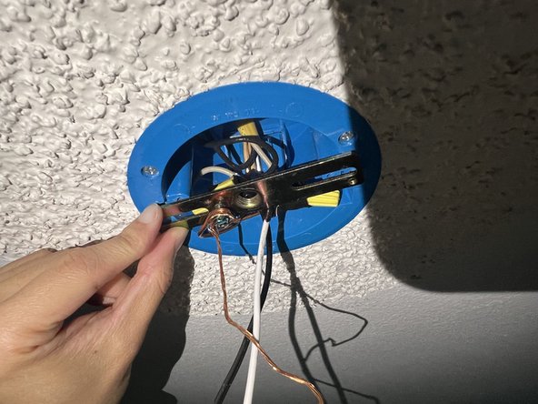

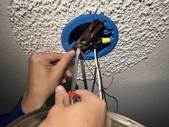

      • Unscrew the screw attached to the metal bracket by twisting the manual Phillips screwdriver until the screw falls off.
      Ask FixBot

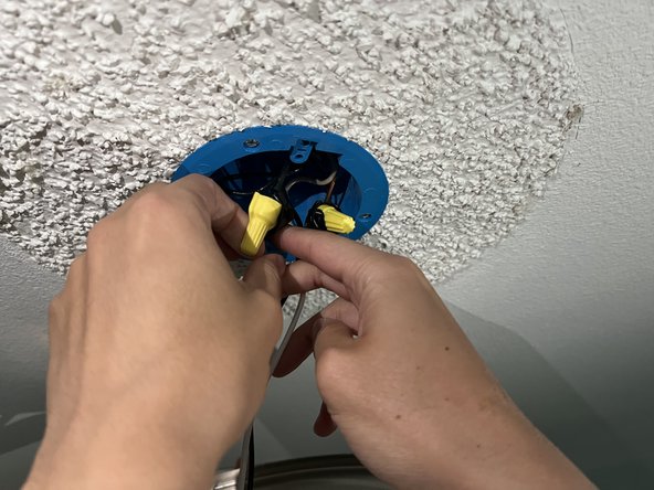

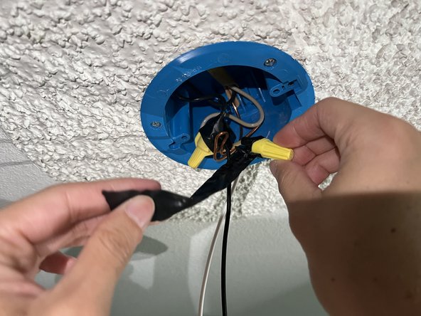

      • Unwrap the electrical tape from around both the black and white wires. These wires will be connected to the base of the light fixture with wire caps (which are yellow in this case).
      • You may want to rest the base of the light fixture on the top of your ladder, or have someone else hold it so that you can use both hands to unwrap the electrical tape.
      Ask FixBot
    9. Replacing an LED Light Fixture: step 9, image 1 of 3 Replacing an LED Light Fixture: step 9, image 2 of 3 Replacing an LED Light Fixture: step 9, image 3 of 3

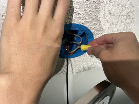

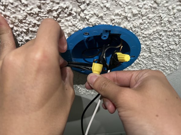

      • Remove the wire caps from the black and white wires and place them aside.
      Ask FixBot
    10. Replacing an LED Light Fixture: step 10, image 1 of 3 Replacing an LED Light Fixture: step 10, image 2 of 3 Replacing an LED Light Fixture: step 10, image 3 of 3
      • Place a piece of electrical tape on the two black wires joined together by the yellow wire connector.
      • Wrap the electrical tape a few times around the wire until both wires are securely wrapped together.
      • Follow the same steps for the white wires.

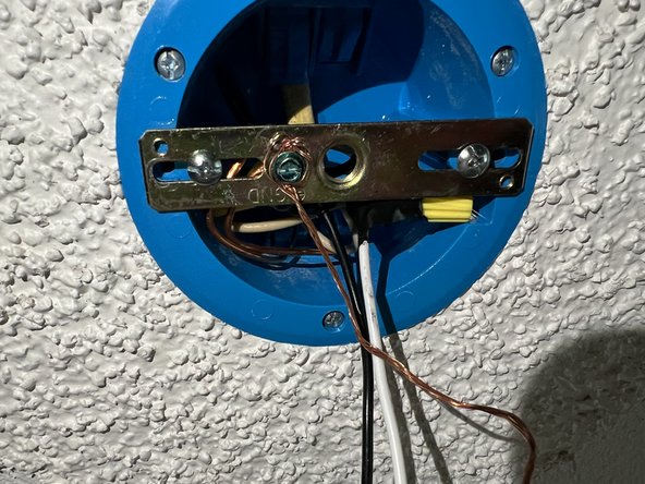

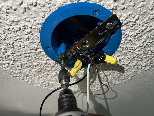

      • Screw on the new metal bracket from the replacement light fixture by twisting the manual Phillips screwdriver until the screw is snuggly holding the bracket.
      • This bracket will be placed in the same location that the original bracket was in, so the screw will screw into the same place as the original screw.
      Ask FixBot
    12. Replacing an LED Light Fixture: step 12, image 1 of 3 Replacing an LED Light Fixture: step 12, image 2 of 3 Replacing an LED Light Fixture: step 12, image 3 of 3
      • Screw on the remaining screws into the metal bracket so that it is firmly attached to the ceiling.
      Ask FixBot

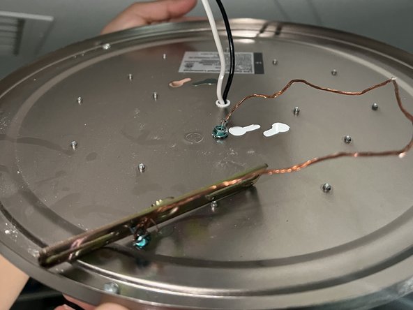

      • While holding the base of the new light fixture, tuck the black and white wires into the electrical box so that there is very little slack in the wires.
      Ask FixBot
    14. Replacing an LED Light Fixture: step 14, image 1 of 2 Replacing an LED Light Fixture: step 14, image 2 of 2
      • Screw the base of the new light fixture into place.
      Ask FixBot
