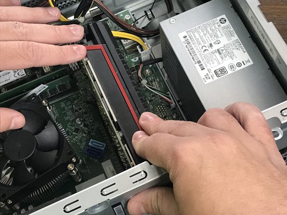

  8. Replacement of Graphics Processing Unit (GPU) in a HP Pavilion 690: step 8, image 1 of 2 Replacement of Graphics Processing Unit (GPU) in a HP Pavilion 690: step 8, image 2 of 2
    • Unscrew the screws on the latch on the back of the computer.
    Ask FixBot
  9. Replacement of Graphics Processing Unit (GPU) in a HP Pavilion 690: step 9, image 1 of 2 Replacement of Graphics Processing Unit (GPU) in a HP Pavilion 690: step 9, image 2 of 2
    • Flip the open the latch on the back of the computer.
    Ask FixBot
  10. Replacement of Graphics Processing Unit (GPU) in a HP Pavilion 690: step 10, image 1 of 1
    • Disconnect the power cable from the GPU.
    Ask FixBot
  11. Replacement of Graphics Processing Unit (GPU) in a HP Pavilion 690: step 11, image 1 of 1
    • Press down on the small lever at the base of the GPU to release the component.
    • Caution: When reassembling do not press this lever. It can lead to an improperly seated GPU and may damage the slot or the GPU.
    Ask FixBot
  12. Replacement of Graphics Processing Unit (GPU) in a HP Pavilion 690: step 12, image 1 of 2 Replacement of Graphics Processing Unit (GPU) in a HP Pavilion 690: step 12, image 2 of 2
    • Pull the GPU gently out of the computer.
    Ask FixBot
  13. Replacement of Graphics Processing Unit (GPU) in a HP Pavilion 690: step 13, image 1 of 2 Replacement of Graphics Processing Unit (GPU) in a HP Pavilion 690: step 13, image 2 of 2
    • Slide the replacement GPU into the slot.
    Ask FixBot
