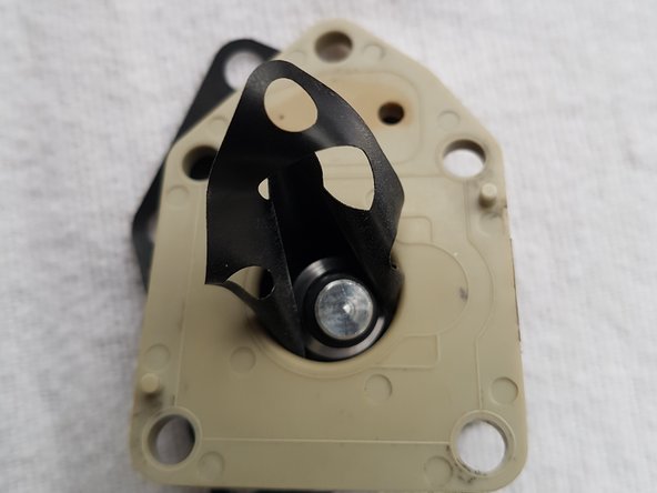

    • Using a PH2 Phillips screwdriver, remove the five screws from the diaphragm cover and carefully lift it off. Caution: The diaphragm spring is under tension and may pop out when opening the cover.
    • Diaphragm
    • Diaphragm spring
    • Diaphragm cover
    • Inspect the seal kit and clean the parts if necessary.
    • Now remove the diaphragm together with the backing plate.

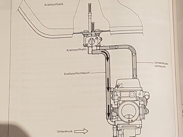

    • Here's a diagram that shows how the fuel tap works.

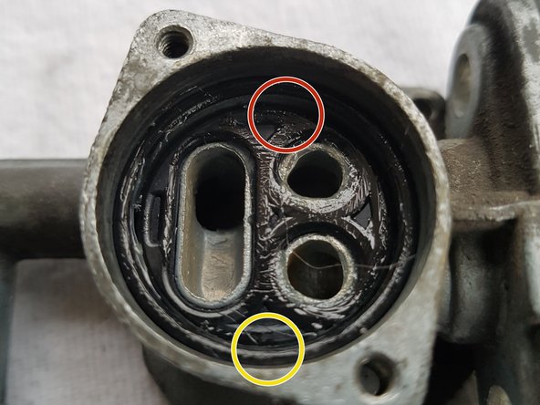

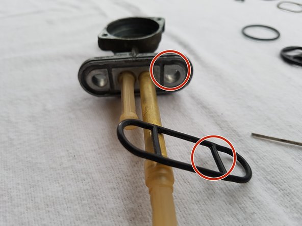

    • Lightly grease all three gaskets. Use the metal spudger to remove the old seals. You can press the new ones in by hand.
    • Insert the sealing plate
    • Place the O-ring into the body
  8. Replace the Fuel Tap Diaphragm and Gaskets on a Suzuki DR650 SE: step 8, image 1 of 3 Replace the Fuel Tap Diaphragm and Gaskets on a Suzuki DR650 SE: step 8, image 2 of 3 Replace the Fuel Tap Diaphragm and Gaskets on a Suzuki DR650 SE: step 8, image 3 of 3

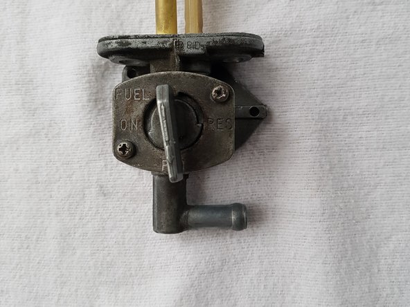

    • Insert the spring washer and the cover plate into the actuator, then install it into the main body. ⚠️ Make sure the spring washer doesn't get pinched during assembly. You’ll notice this if the fuel tap gets stuck when turning from "On" to "Res"—this indicates the washer is misaligned and needs to be repositioned.

    • Reinstall the fuel tap onto the tank.
    • Don’t forget to place the two sealing washers under the mounting screws.
