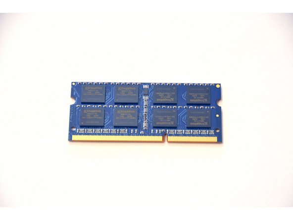

    1. Replace or expand RAM memory, RAM memory: step 4, image 1 of 3 Replace or expand RAM memory, RAM memory: step 4, image 2 of 3 Replace or expand RAM memory, RAM memory: step 4, image 3 of 3
      • Here is the default installed memory module.
      • Locate and squeeze the tension springs that secure the memory module apart.
      • Pull the memory module (RAM) out of its plug.
      Ask FixBot
    2. Replace or expand RAM memory: step 5, image 1 of 1
      • This is what the remote memory module looks like.
      Ask FixBot
To assemble the device again, proceed in reverse order.
