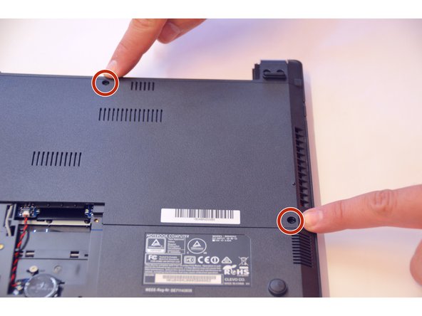

    1. Replace fan, Top cover: step 2, image 1 of 3 Replace fan, Top cover: step 2, image 2 of 3 Replace fan, Top cover: step 2, image 3 of 3
      • Using a Philips-head screwdriver remove highlighted screws.
      • Look at the marking to see how to remove the access cover.
      • Remove the access cover as shown by the marker.
      Ask FixBot

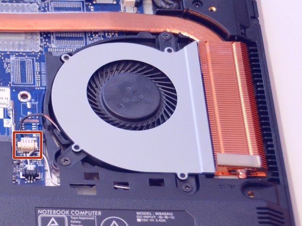

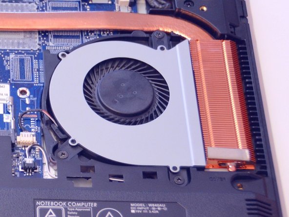

    1. Replace fan, fan: step 4, image 1 of 3 Replace fan, fan: step 4, image 2 of 3 Replace fan, fan: step 4, image 3 of 3
      • There is the fan.
      • Then pull out the supply cable of the fan.
      • Remove the 3 mounting screws of the fan.
      Ask FixBot
    2. Replace fan: step 5, image 1 of 1
      Ask FixBot
