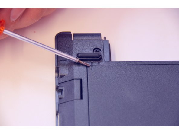

    1. Replace WLAN / Bluetooth chipset, Main access cover: step 2, image 1 of 3 Replace WLAN / Bluetooth chipset, Main access cover: step 2, image 2 of 3 Replace WLAN / Bluetooth chipset, Main access cover: step 2, image 3 of 3
      • Using a Philips-head screwdriver remove highlighted screws.
      • Look at the marking to see how to remove the access cover.
      • Remove the access cover as shown by the marker.

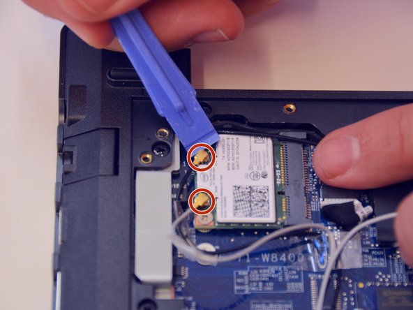

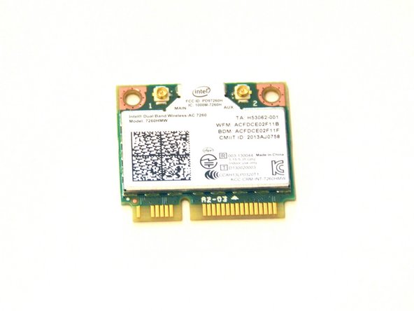

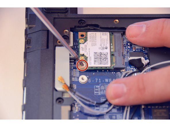

    1. Replace WLAN / Bluetooth chipset, WLAN/Bluetooth Chipset: step 4, image 1 of 3 Replace WLAN / Bluetooth chipset, WLAN/Bluetooth Chipset: step 4, image 2 of 3 Replace WLAN / Bluetooth chipset, WLAN/Bluetooth Chipset: step 4, image 3 of 3
      • Here is the chipset WLAN / Bluetooth.
      • Carefully loosen the antenna plugs MAIN and AUX.
      • Loosen the fixing screw with the Philips screwdriver.

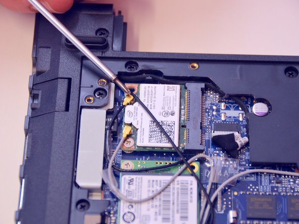

    2. Replace WLAN / Bluetooth chipset: step 5, image 1 of 2 Replace WLAN / Bluetooth chipset: step 5, image 2 of 2
      • Lift the chipset a little and pull it out to the mSATA connector.
