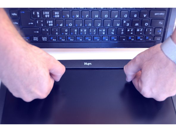

    1. Replace LCD screen, LCD screen: step 2, image 1 of 3 Replace LCD screen, LCD screen: step 2, image 2 of 3 Replace LCD screen, LCD screen: step 2, image 3 of 3
      • Carefully slide the nail between the frame and the glass of the screen.
      • First clip off the mounting points of the LCD screen frame.
      Ask FixBot

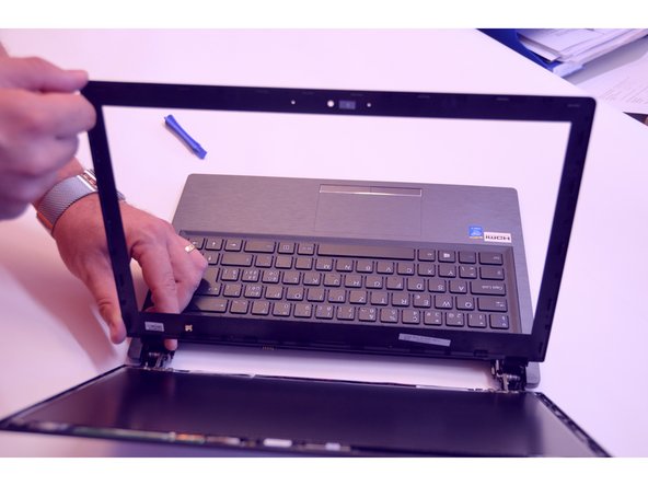

    2. Replace LCD screen: step 3, image 1 of 3 Replace LCD screen: step 3, image 2 of 3 Replace LCD screen: step 3, image 3 of 3
      • Free the LCD screen frame completely.
      • Locate and loosen the two upper mounting screws of the LCD screen.
      • Locate and loosen the two lower mounting screws of the LCD screen.
      Ask FixBot

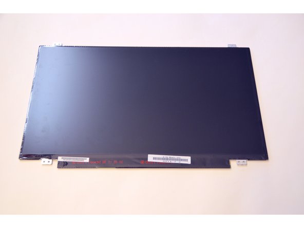

    3. Replace LCD screen: step 4, image 1 of 3 Replace LCD screen: step 4, image 2 of 3 Replace LCD screen: step 4, image 3 of 3
      • Carefully place the LCD screen on the keyboard.
      • Locate the plug of the LCD screen.
      • Free the fixing cable.
      Ask FixBot

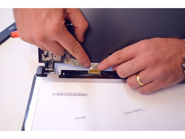

    4. Replace LCD screen: step 5, image 1 of 2 Replace LCD screen: step 5, image 2 of 2
      • Disconnect the cable from its plug.
      • Then lift out the LCD screen.
      Ask FixBot
