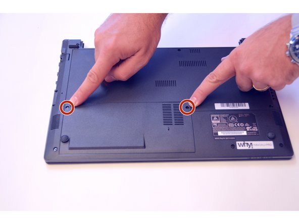

    1. Replace HDD hard disk, Access to the components 1: step 2, image 1 of 3 Replace HDD hard disk, Access to the components 1: step 2, image 2 of 3 Replace HDD hard disk, Access to the components 1: step 2, image 3 of 3
      • Use the Philips screwdriver to remove the two screws on the bottom cover.
      • Check the markers to determine how to remove the cover.
      • Now remove the cover as prescribed by the markers.

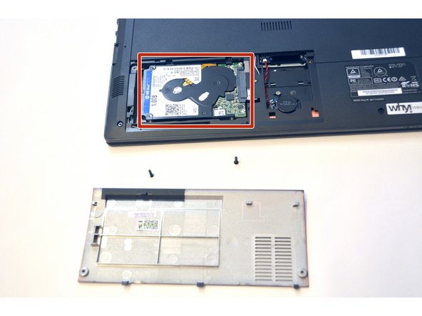

    2. Replace HDD hard disk: step 3, image 1 of 1
      • The components HDD hard disk and BIOS battery are now visible.
      Ask FixBot
    1. Replace HDD hard disk, HDD hard disk: step 4, image 1 of 2 Replace HDD hard disk, HDD hard disk: step 4, image 2 of 2
      • Unplug the HDD hard drive from its SATA3 connector.
      • This is what the HDD hard drive looks like
