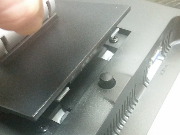

1. remove plinth from monitor by pressing the button on the back of the screen

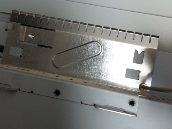

5. You will see two shiny shields fixed with two screws, remove the screws and you can pop/slide the shields off.

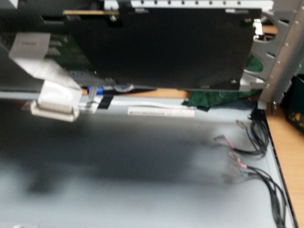

6. Once they are removed, you will see one connecting to the screen which has two levers either side, press those in and wiggle the ribbon cable out.

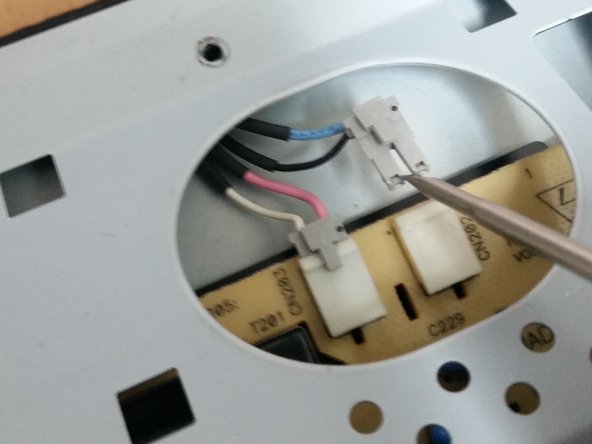

7. on the other side you'll see a smaller ribbon cable which simply pulls out. You'll also see the high tension plugs which were under one of the RF shields they are usually pink and blue, make a note of which goes into where and unplug
8. You're now ready to remove the screws around the edge of the LCD screen and it should come off as one unit.

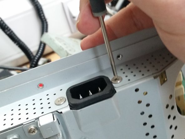

10. Locate where the power is usually plugged in and you'll see two screws either side of the power socket remove those.

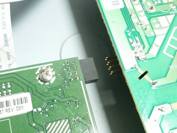

11. You should see that the power supply board is now loose and can be wiggled free making sure you don't damage the berg strip connector which attaches it to the other board. it usually comes out at a slight angle quite easily.

      • 1. remove plinth from monitor by pressing the button on the back of the screen

      • remove back of monitor and remove the shiny steel RF shields one screw each then then simply slide off

      • The small ribbon cable is easy to remove gently pull (see picture), the larger ribbon cable can be stubborn I tend to use two screwdrivers one to push in the release catch and the other flat bladed one to gently wiggle it out, same procedure for the other side, if you get image corruption after the repair this is the cable that is the culprit

    5. Repairing LCD monitor Dell 17", Remove the CCFL Inverter Power/Signal Connectors: step 5, image 1 of 1
      • There are 4 of them

      • remove the 4 screws one is bigger than the rest then undo the screws that hold the power cable socket in place, once the power socket screws and the top board screws are removed put your thumb over the power socket and pop the board out sideways you don't need a great deal of force to remove the PSU board just loosen gently

      • take note of the berg strip and make sure you don't damage the pins when removing flip the board over and you're ready to remove the capacitors C203 & C204 and replace making sure polarity is correct, when re-assembling make sure the berg strip lines up correctly before pushing the boards together
