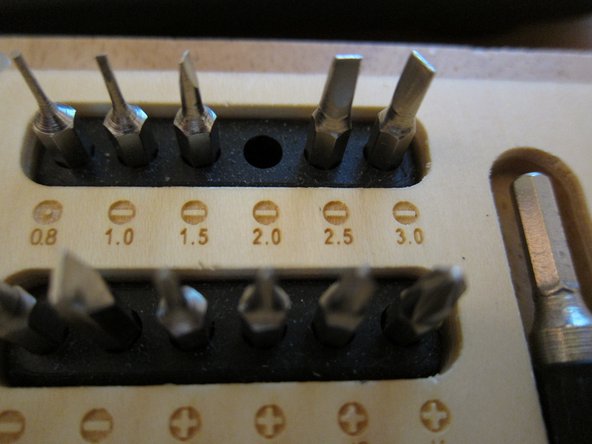

  3. Repairing Brainwavz M5 Headset Grommet between the headphone wire and earbud, Get Tools: step 3, image 1 of 1
    • You will need 2 types of tools: 1 to insert the wide flaps and 1 to poke stray bits fully into the hole.
    • For the wide flaps, use a 2.0 flathead bit. Do not use a 1.0 bit; it is too narrow.
    • For the stray bits, the iFixit plastic spudger works great.
