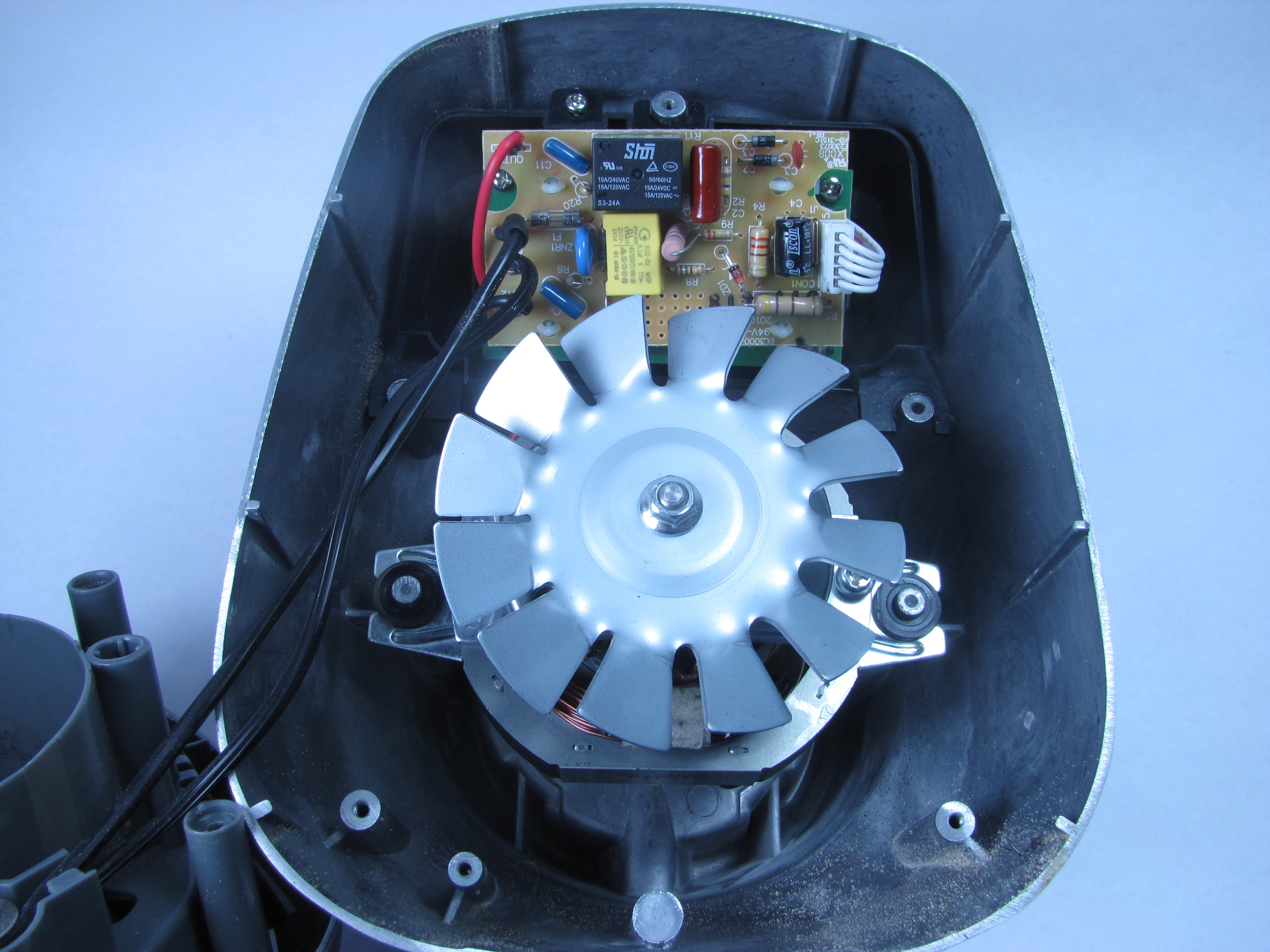

  5. Repairing Black and Decker BL3000S Power Cord: step 5, image 1 of 1
    • Lift the top half of the base from the bottom half of the base to reveal the internal mechanism.
  6. Repairing Black and Decker BL3000S Power Cord, Power Cord: step 6, image 1 of 1
    • Tug on wires in the marked locations to make sure they are secure.
    • If the wire stays still, the connection is secure.
    • If you still have problems with the blender, it is probably a problem with the motor. Since the motor is irreplaceable, you will have to order a new blender.
  7. Repairing Black and Decker BL3000S Power Cord: step 7, image 1 of 1
    • If the wire comes off, the connection is insecure. You will need to solder the connection to make it solid again.
    • If you don't know how to solder, here is a link to show you how. http://www.aaroncake.net/electronics/sol...
