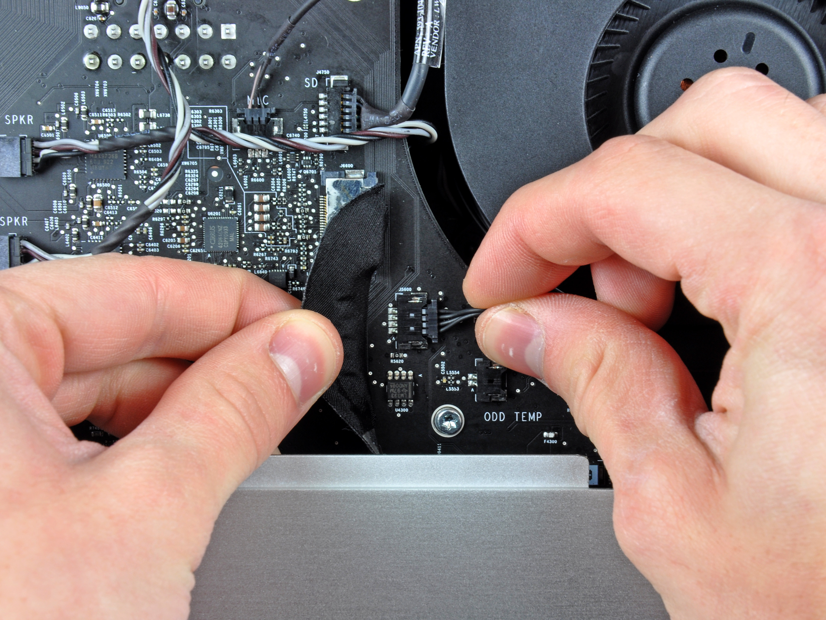

  11. iMac Intel 27" EMC 2309 and 2374 Optical Drive Fan Replacement: step 11, image 1 of 1
    • Pull the optical drive thermal sensor connector straight away from its socket on the logic board.
