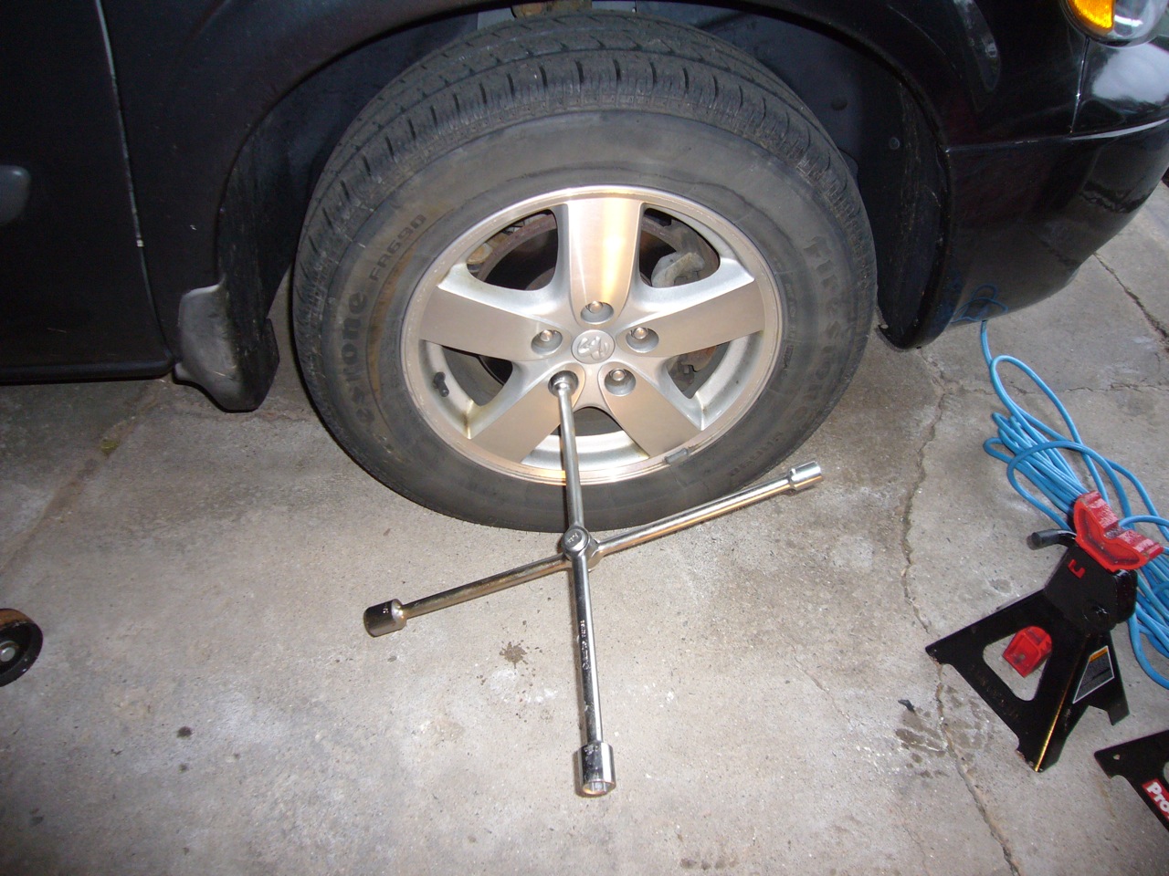

  1. 2001-2007 Dodge Caravan Brake Pads and Rotors Replacement, Remove wheel: step 1, image 1 of 1
    • WARNING: Injury may result if this procedure is not followed properly. Use caution and follow all warnings.
    • Loosen the lug nuts one half turn while the tire is still on the ground. A large amount of force may be required and the tire will just rotate if the car is on jackstands.
