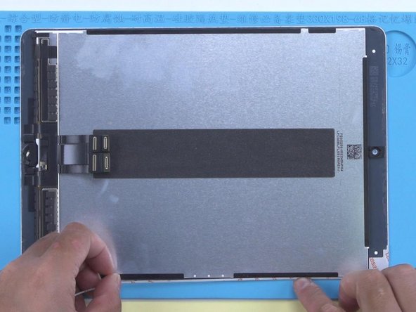

    • Next, we need to disassemble the iPad Pro for testing. Put the iPad Pro on the Heating Pad to heat.
    • When the temperature reaches about 70 °C, separate the screen with a Pry Piece. Please pay attention to the angle and direction to avoid damaging the flex cables.

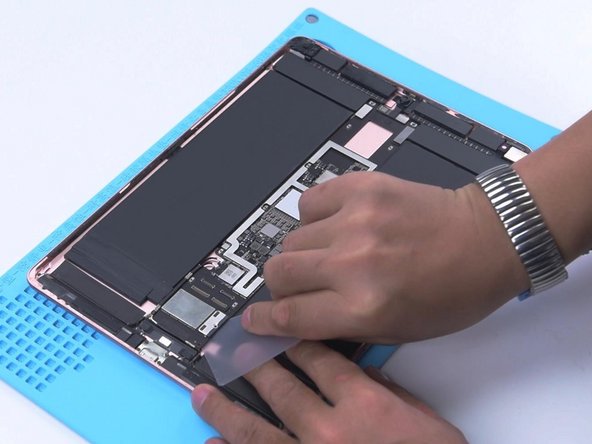

    • Insert a Pry Piece between the battery and motherboard. Disconnect the battery.

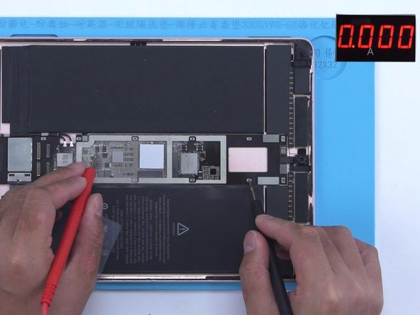

    • Then we check if the boot current of the motherboard is normal. Power up the motherboard with a Direct Current Supply. When the probes touch the main power supply circuit of the motherboard and the boot-up hasn't been triggered, the current directly jumps to 2.7 A.
    • We can confirm that the main power supply circuit of the motherboard is short-circuited, leading to the not turning on issue. Then we measure the diode values of the main power supply circuit with diode mode of the multimeter. The diode value is 534, which is normal.
    • When measuring a nearby capacitor, the diode value is 0. It indicates that the circuit is shorted.

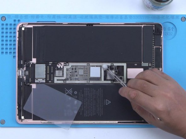

    • Since there are too many related components on the circuit, we use rosin detecting to find the short-circuited component. The Rosin Dispenser is used to dispense rosin this time. Compared to the traditional soldering iron, the operation is easier with better effect.
    • Then we apply a voltage of 3 V to the motherboard. It can be seen under the microscope that rosin on a capacitor has melted. We can judge that the capacitor is damaged.
