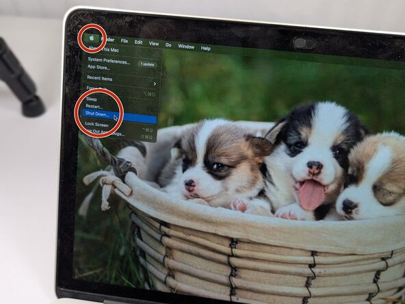

    • Power off the MacBook by clicking on the Apple logo in the top left corner of the screen. Then, scroll down the list and click "Shut Down."
    • Disconnect any attached cables such as chargers or wired headphones.
    • Disconnecting cables before beginning this repair is crucial to avoid moisture damage and electrical shocks. Cables should not be present in order to fully clean the ports and connectors.

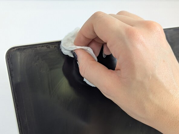

    • Gently wipe the screen's surface with either a microfiber cloth or cotton pad to remove any residual dust or oil.

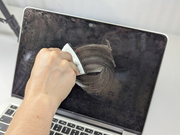

    • Apply a mild plastic polish or cleaning solution like Bar Keeper’s Friend (liquid) to a cotton pad.
  4. Removing the Anti-Glare Coating from a MacBook Pro Screen: step 4, image 1 of 2 Removing the Anti-Glare Coating from a MacBook Pro Screen: step 4, image 2 of 2
    • Softly rub the coating from the cotton pad onto the MacBook's screen in small circular motions.
    • Be careful not to damage the screen underneath.
  5. Removing the Anti-Glare Coating from a MacBook Pro Screen: step 5, image 1 of 1
    • Wipe the screen clean with a new microfiber cloth or cotton pad. Inspect for remaining coating.
    • If the damaged anti-glare coating still remains, repeat this process as many times as needed.
