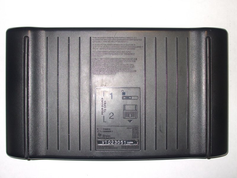

      • The first step to any repair operation is to remove the front cover.
      • Grab the back of the calculator with one hand and the cover with the other.
      • Pull the cover off from one of the sides for easy removal.

      • Orientate the calculator with the top facing towards you.
      • Slide the locking tab,found on the top part of the calculator, to the unlock position.
      Ask FixBot
    3. Removing Texas Instruments TI-92 Back Cover: step 3, image 1 of 2 Removing Texas Instruments TI-92 Back Cover: step 3, image 2 of 2
      • "Locking Tab"
      • To remove the back cover, slide the cover away from the locking tab towards the bottom of the calculator until the cover no longer slides.
      • Then with the front of the calculator facing down, pull up on the back cover.
      • The calculator should now be orientated with the front facing down, as shown in picture 2.
